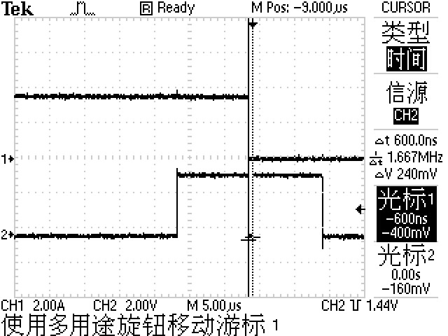

     Today, I do some test,the test results are as following,
    When task 3 is entered, a gpio(channel 2) is set, and when task 3 is finished(is executed completely),the gpio(channel 2) is drived low, task 3's period is 1ms.From the first attchment,we can see task 3 is executed twice,and the blank time is 600ns,It should be 1ms just as the second attachment.
    Please take some time to review my code,Thanks!

  • Victor,
    Some questions:
     - what is channel 1 in the two oscilloscope plots you sent?
     - what is triggering task 3?  Do you have a hardware timer set up and if so, which one?
    Richard
  • Dear Richard,
    I show task 3 code as follows,
    if(rtTaskTimer[3].flag)
    DTS1 = 1;
    if(taskBusyStatus.word&0x0007)
           return;
    DINT;
    rtTaskTimer[3].flag = 0;
    if(taskBusyStatus.bit.task3Busy)
           taskReenStatus.bit.task3Reen = 1;
    else
           taskBusyStatus.bit.task3Busy = 1;
    EINT;
    DTS2 = 1;
    count1++;
    //task 3......
    DTS2 = 0;
    DINT;
    taskBusyStatus.bit.task3Busy = 0;
    EINT;
    DTS1 = 0;
    channel one is sent by gpio DTS1 and channel 2 is sent by gpio DTS2.From above two pictures,Plots on first picture
    are wrong and it occurs occasionally.Plots on second picture are right.
    rtTaskTimer[3].flag is set in the task 0(its priority is highest) and cleared in task 3
    taskBusyStatus.word&0x0007 is for detecting Whether there are higher priority tasks
    There is a task(its priority is highest and its executed period is 62.5us) is triggered by hardware timer.
    In fact,there are two interrupt sources for the task,EPwm1 is ET_CTR_ZERO interrupt and EPwm2 is ET_CTR_PRD interrupt,their periods are both 125us.So the task is executed on every 62.5us.

  • When you ran with a period of 125 us, was it from changing the actual period of the PWM or did you disable the ePWM2 interrupt as Richard suggested?
    The first scope capture you shared looks like it might be the EPWM ISR being preempted by the EPWM ISR (probably at the EINT; before the DTS2 = 1;). Do you want it to be able to do that? I see you're re-enabling group 3 at the start of the ISR, so I assume so...?
    Whitney

    -The first scope capture you shared looks like it might be the EPWM ISR being preempted by the EPWM ISR (probably at the EINT; before the DTS2 = 1;). Do you want it to be able to do that? I see you're re-enabling group 3 at the start of the ISR, so I assume so...?
    In my code,EPWM ISR can be preempted by itself. there are 8 tasks in my system,
    and task 0(period is 62.5us) should be completed in 62.5us,
    task 1(period is 125us) should be completed in 125us and it can be preempted by task 0,
    task 2(period is 250us) should be completed in 250us and it can be preempted by task 0 and task 1
    task 3(period is 625us) should be completed in 250us and it can be preempted by task 0 ,task 1,task 2
    task 4(period is 1ms) should be completed in 250us and it can be preempted by task 0 ,task 1,task 2 ,task 3
    task 5(period is 10ms) should be completed in 250us and it can be preempted by task 0 ,task 1,task 2 ,task 3,task 4
    task 6(period is 330s) should be completed in 250us and it can be preempted by task 0 ,task 1,task 2 ,task 3,task 4 ,task 5
    task 7(period is 1s) should be completed in 1s and it can be preempted by task 0 ,task 1,task 2 ,task 3,task 4 ,task 5 and task 6
