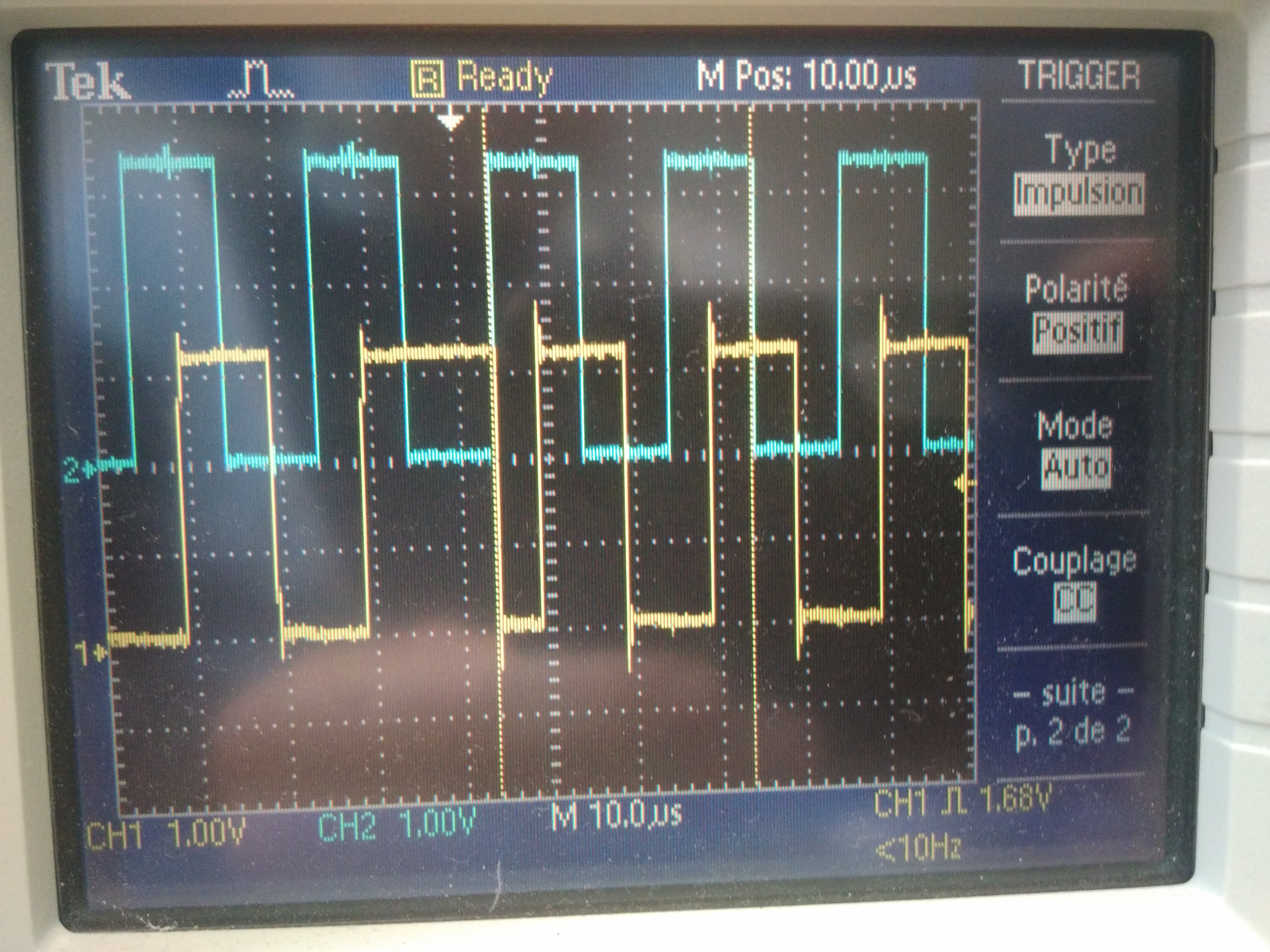

Compiler/TMS320F28379D: Leaving the pwm output when changing the phase (between epwm1 and epwm2) shift between are 0-90° to area 90°-180° .
Part Number: TMS320F28379D
I encounter a jump of pwm during the evolution of the phase shift control of the zone 0-90 ° to 90 ° -180 °.
Here is the config of my timer:

as well as the modification of the phase of the timer 2 in the interruption of timer 1:
