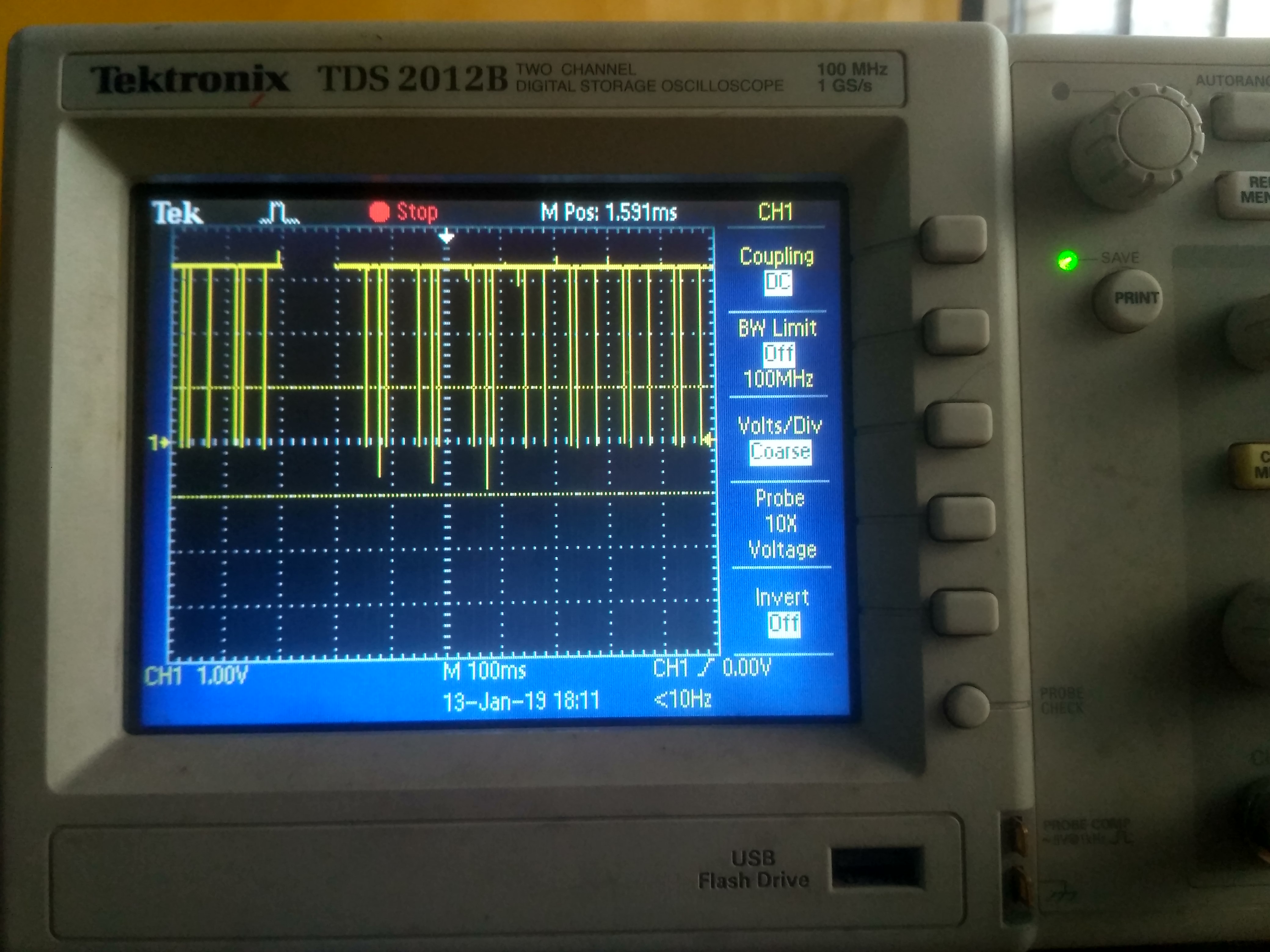

  • Panda,
    Please explain in detail what you are trying to do. We can't go through the code to figure that out.
    Manoj
  • Manoj,
    I want to know what should be my output, as i am getting a constant 3.3V output, how can I get a pulsed output by adjusting the delay() function or by adjusting the sampling time.
    Thank you
    Bighnaraj Panda
  • Manoj,
    I have given different values in the delay(1000) and delay(250) and also the value given in the example program functions but the output is not changing. I have also adjusted the number of samples as synchronous with the sysclock
    GpioCtrlRegs.GPAQSEL1.bit.GPIO1 = 2; // XINT2 Qual using 6 samples
    but still there is no effect on the output. Please help me to find the fault.
    Thank you
    Bighnaraj Panda
  • Panda,
    I believe this is what you are trying to do:-
    1) GPIO0 is configured to trigger XINT1 and GPIO1 is configured to trigger XINT2
    2) GPIO24 and GPIO29 is configured as GPIO output pin.
    3) GPIO24 is connected to GPIO0 pin
    4) GPIO29 is connected to GPIO1 pin
    5) Use GPIO34 to monitor in scope.

    Manoj
  • Manoj,
    I have set the SYSCLKOUT frequency at 200MHz and a delay of (1000*6*510). The output is the image in which I am not able to understand the output. Can you please make me understand how this output is related to the programming input.
    Thank you
    Bighnaraj Panda
  • Panda,
    According to the example, GPIO34 will not toggle unless XINT1 and XINT2 interrupt are triggered. GPIO0 triggers XINT1 and GPIO1 triggers XINT2 interrupt.
    Manoj
  • Manoj,
    You mean to say that in my program the interrupt is not getting triggered? But I have connected GPIO0 to GPIO24 and GPIO1 to GPIO29 externally and connected the probe to GPIO34. Then XINT1 and XINT2 interrupt are not triggered.
    Thank you
    Bighnaraj Panda
  • Panda,
    As I mentioned before, there were some configuration issues in your code and external interrupts weren't getting generated.
    Manoj
  • Still the program is not running correctly as mentioned above due to some configuration issues how to sort out those issues please help me.
    Thank you
    Bighnaraj Panda
  • Panda,
    Please explain the problem.
    Manoj
  • Panda,
    Are you saying that modified program I gave is also not working? Your oscilloscope snapshot seems to suggest that the code is working.
    Before I sent you the code, I made sure that the code is working.
    Manoj
