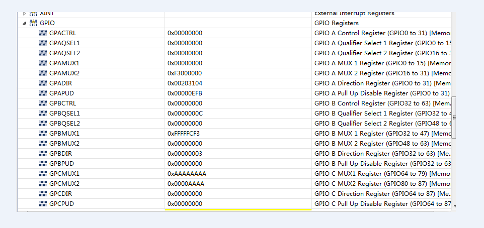

    GPIO qualification config as below. GPIO33 as I2C is configured as asyn. Others XINTF GPIOs are synchronized to SYSCLKOUT.
    The issue is totally about reading. It is correct at the first beginning. But after several times readying, one bit is changed from 1 to o. Then XINTF write back the right value 1, and read several times with the correct value 1. And then it fails again with reading a wrong value 0.

  • Jordan,
    All known XINTF issues are documented in the Errata.
    Try configuring the qualification of XINTF pins to be Asynch in the GPIO QSEL registers.
