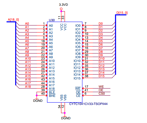

  • user5358342,
    Can you describe the memory component that you are using with EPI?
    -Tommy
  • CY7C1041CV33-TS0PII44

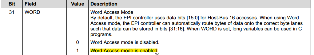

  • EPIAddressMapSet(EPI0_BASE, (EPI_ADDR_RAM_SIZE_16MB|EPI_ADDR_PER_SIZE_16MB|EPI_ADDR_CODE_SIZE_16MB |EPI_ADDR_PER_BASE_E| EPI_ADDR_RAM_BASE_68) );
    Please double-check your address base value.  EPI_ADDR_RAM_BASE_68 is not valid.
    HWREG(EPI0_BASE + EPI_O_HB16CFG2) = (EPI_HB16CFG2_CSCFGEXT |EPI_HB16CFG2_CSCFG_ADCS);
    This register write is overwriting your settings from EPIConfigHB16Set().
  • If you are still having issues, please provide the signal mapping that you are using between the SRAM pin names vs the F28M35H52C pin names.
  • it means Only to be used with Host Bus quad chip select. In quad chip select mode, CS0 maps to
    0x6000.0000 and CS1 maps to 0x8000.0000
    -----so  there is no problem , I have made the right configuration.
    "This register write is overwriting your settings from EPIConfigHB16Set()."
    In fact , the register is not be configuration at the EPIConfigHB16Set(). but  I fond the anwser is that  I am not setting the EPI_O_HB16CFG2
    Thank you for you anwser ,   I am very  appreciate.
