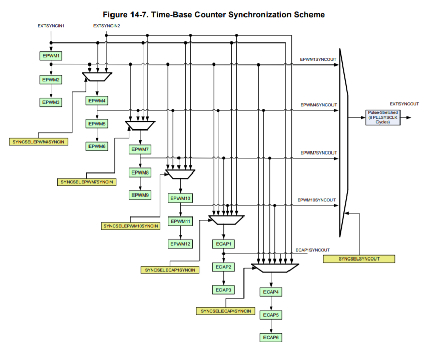

Part Number: TMS320F280049C
I'm trying to synchronize 4PWMs in HRPWM up-count mode. If I do not change the period, all 4 PWMs will be in sync, but if I change it when the PWMs are running the ePWM4 goes out of sync. The period and the duty cycle are correct but it will be phase shifted. If I enable the ePWM5 it will be in the same sync as ePWM4. Below is the initialization of the PWMs. I have added 32-bit access to period register.

Any ideas?
