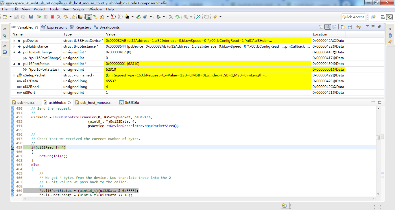

Question1: I defined the variable uint16_t ui16Status in the function and assigned the initial value ui16Status = 0.In calling a function as a parameter,
Find that the value was assigned, but the value did not change?
The problem is that the address of ui16Status is 0x00000418, *pui16PortStatus assigns an address 0x00000001 instead of 0x00000418???How to solve?

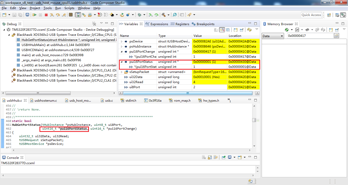

  • Hi George:
     The first picture is as follows:
    • Set a breakpoint before the function HubGetPortStatus.
     The second picture is as follows:
    • When you step to line 425.

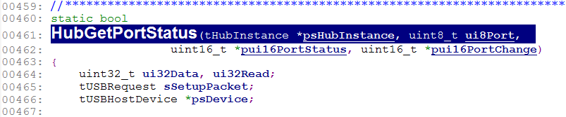

    • Set a breakpoint at the very first instruction, not C statement, in the function HubGetPortStatus.  The argument &ui16Status is passed in the register XAR5.
    The third picture is as follows:
    • When you step to line 433.

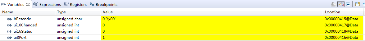

    The fourth picture is as follows:
    • When you step to line 459.

  • This is the program state as of the third picture.  The pointer pui16PortStatus resides at memory location 0x430.  It contains the value 0x418.  Memory location 0x418 contains the value 0.  All of this is correct.
    Sometime between the third picture and the fourth picture things go bad. The memory location 0x430 no longer contains the value 0x418.  It contains the value 1 instead.  It goes downhill from there.
    I cannot tell what causes the memory location 0x430 to be overwritten with the value 1.  You have to use your debug skills to find the moment where that occurs.  Maybe it happens during execution of the function USBHCDControlTransfer?
