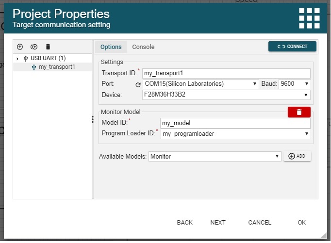

I am trying to get my Gui Composer application to connect with USB-UART. I have added the serial monitor code to my target, (M3 core of the Concerto) and added the USB-UART communication monitor in the Gui properties. I am able to get it working in CCS by doing the following: my target is running from either flash or ram,I add Uart communication in the configurations file and then load symbols to the UARTConnection in the debug view. I can then view all variables in the expressions window, and if I export my gui to CCS desktop view and run it from CCS it connects to my target and updates the values. However, I am not able to get the UART connection working while running the gui from the gui composer cloud web interface or when exporting the gui to standalone app. In both cases I only get an error: "TICloudAgent Config Error:Failed to connect to F28M36H33B2 device: Please unplug your hardware, then plug it back in and try again". The latter is actually what I would like to do, to have a stand-alone app that connects to the target using USB-UART. Note that the xds connection works perfectly from the cloud and from CCS. Why would the USB-UART connection work in CCS but not the stand-alone app or from the cloud?

  • Can you explain what you mean when you say, " I am not able to get the UART connection working while running the gui from the gui composer cloud web interface or when exporting the gui to standalone app" ?
    My Gui only connects to the target device when exported to CCS desktop view, not any of the other methods of running the gui.
    Are you able to load the symbols/program into the device properly?
    Yes. With CCS desktop view I load the symbols and then it connects correctly. With the cloud interface I click the auto load checkbox in properties, it loads the program successfully but does not connect (variables does not get updated). With the standalone app I pre-load the program into flash and let it run, then try to connect the app to the target but it does not connect (variables does not get updated).
    Is it just that the UART/SCI communication is not being received by the GUI composer cloud interface or when exporting to the standalone app?
    Both. I get no communication between the gui and the target when using the cloud interface or the standalone app.
    Have you been successful in communicating over UART/SCI to the GUI cloud or standalone with other programs?
    No I have not done this before.
    I am not very familiar with the GUI composer or cloud tools. This may be an issue with the tool, but I want to rule our SCI or program issues first.
    I don't think the problem lies with the SCI program since it is working fine when I run the gui in CCS Desktop view.
  • Yes I already added the options menu and selected the correct COM port.

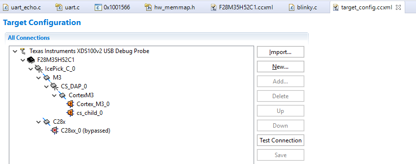

  • Hi Albert,
    I was thinking of a custom configuration that looks like a picture below. It is a little bit different than what you have. Rest of your configuration steps look ok. With custom target_config.ccxml I was trying to eliminate 28x from the picture.
    I have a slightly different control card 28M35HC52 with XDS100v2, I verified that JTAG based approach works with a config as shown below. However, I am having trouble getting simple UART example to work. I tried uart_echo example from ControlSuite, but it does not work as expected. Thus I am not able yet to try and duplicate your setup.

    I lead you the wrong path with how to create a custom xml file. I have synched up with another engineer and we believe that attached file should work. However, I still have not been able to get my board to work, thus I can't confirm that it will work. However, would you be willing to try one more file? Please download attached ccxml, You probably will need to delete the one that was previously uploaded and then upload this new one. You should have only one target_config.ccxml file. Please let me know if this works and I can explain how this was created, if you are interested.

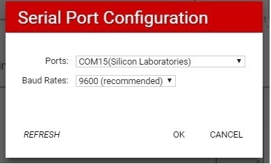

    Here are the steps to add a COM port selection widget to your application and select the COM port when your run the application:
    • In the Palette, enter option in the search box. Drag the Options Menu widget to your applications menu bar. The Options menu might not be correctly added to the position that you drop it into. You can fix this by switching to the HTML mode and move the option tag to the desired location in the menu.
    • Run the application
    • Select the Options/Serial Ports to open the COM selection dialog and choose the correct port
    In the GUI Composer designer, make sure that you don't reflash your device. We don't currently have a way to flash the device with custom ccxml file. We are working on this feature. In the project properties dialog, navigate to the Target programming page. Make sure the Auto Program checkbox is unchecked, but keep the programloader to load symbols for the target monitor.
    I also have adjusted the ccxml file that you have attached, it is similar to the one that Martin sent. But we don't need to include other core to be bypassed. Having the UARTConnection with the M3 core is sufficient. Please upload the attached ccxml to your application. You can upload this file the same way you upload the executable in the Target programming page. Make sure that you select your device program in the droplist after you have uploaded the target_config.ccxml file.
    Let me know if this help you to progress any further. In the mean time, I'll try to get my device working.
    https://e2e.ti.com/cfs-file/__key/communityserver-discussions-components-files/171/0385.target_5F00_config.ccxml

  • Hi Patrick
    I followed your instructions as above and still don't get it to work.
    I have the COM port selection widget and it is selecting the correct COM port. I have the Auto Program checkbox Unchecked. I have my device program selected in the droplist after uploading the target_config.ccxml file.
    It now does not give error message and only gives a message saying "Hardware connected", but nothing is being updated on the GUI as if the symbols are not loaded.
