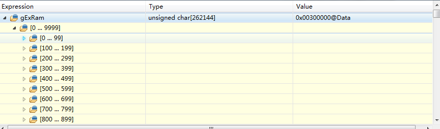

Hello, I found the following problem when accessing external ASRAM through CS3
1.Data with more than 64K RAM per access is written back
2.ASRAM type:62-65WV25616EALL-BLL-CLL   256k*16bit
What is the cause of this problem?
code example:
gExRam[0]=0x1234;
gExRam[1]=0x4212;
gExRam[65537]=0x1112;
