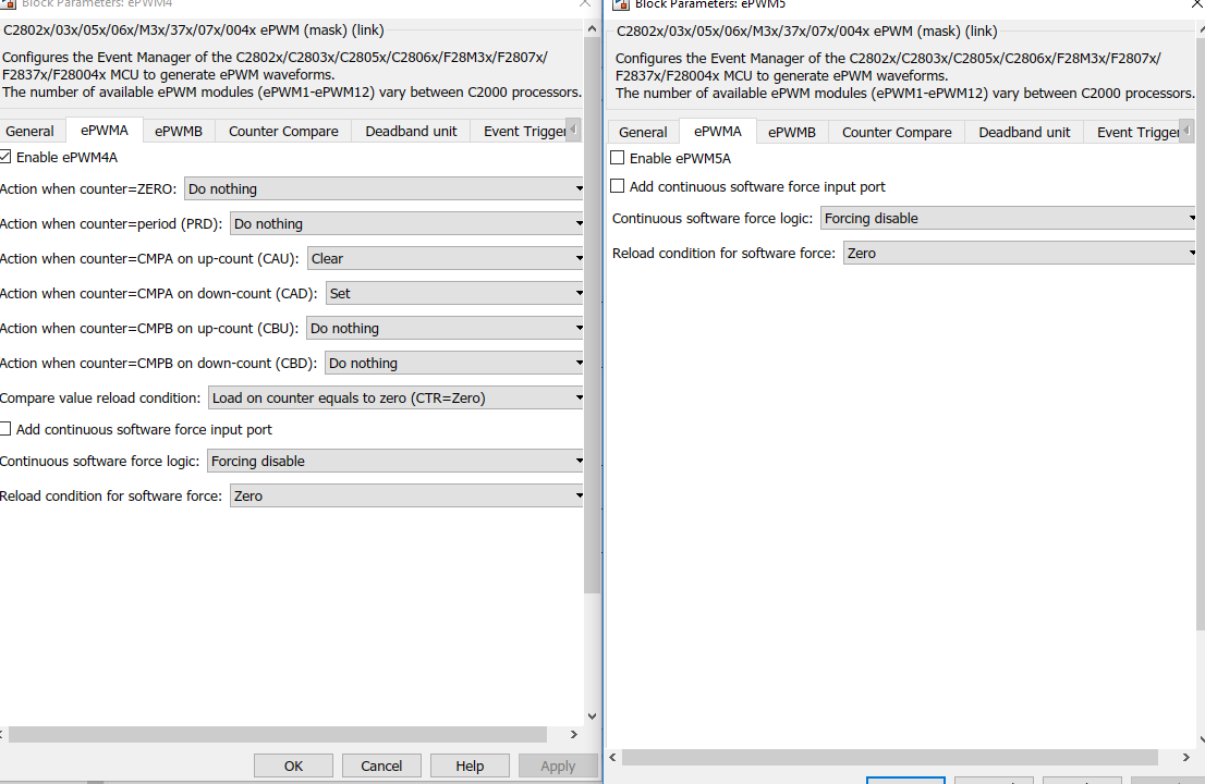

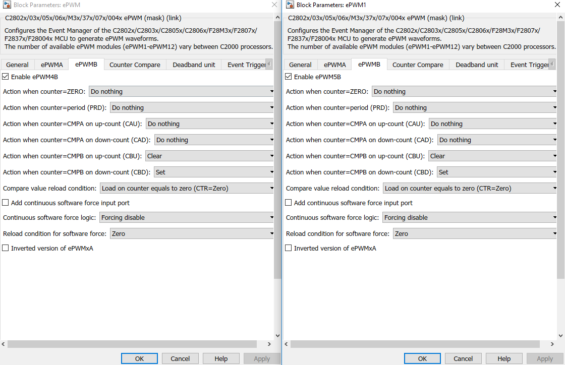

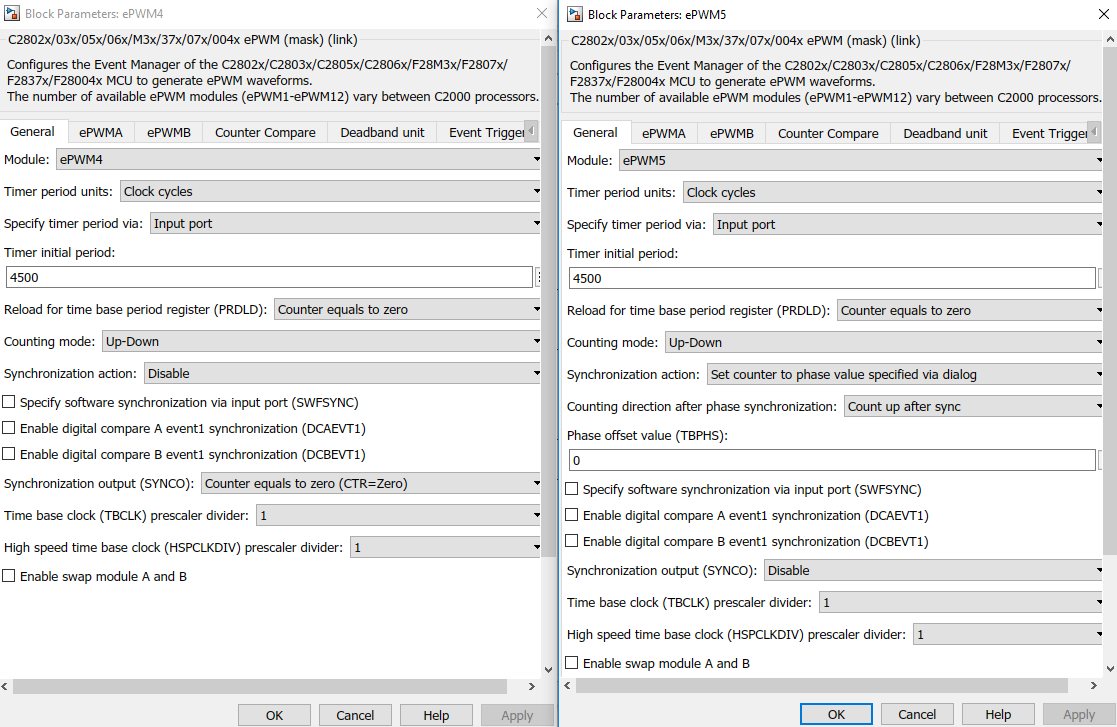

Thanks for helping me in Advance. im now working on TAPAS Board with F28069M for my graduation work. I wanna to achieve the sPWM Output in the H-Bridge, which ist by 2 Half Bridge combined.
The Version of Matlab is 2018b and CCS 8.2.0.  On the Board ePWM4A and ePWM4B Control two FETs separately on Half-Bridge. and then i will use ePWM4A/B and ePWM5A/B to realise the H-Bridge. At the 2 Outputs of 2 channels i linked a resistor in order to measure the Output voltage. the frequency of PWM i set is 10kHz. The Synchronization of 2 ePWM Blocks is also set. In Addition i didn't use the Deadband for each block.
I have already tried it so many times but unfortunately it didnt work. there is Always noise when i download the model to the board, i thought it was short circuited. how can i set the Parameters in the blocks correctly?
Thanks so much if you can give me the answers as soon as possible, i will appreciate it.
 below are the configuration of ePWM blocks. Here is the Model i tried
The Phase of second "Sine Wave" is delayed pi rad in order to realise the invertede Sine Wave, and the sample time i set is 1e-5, although i think 1e-4 is already enough.
The configuration of wPWMs.
ePWM4A and ePWM5A for the Control of above MOSFET in 2 Half-Bridge.
ePWM4B and ePWM5B for the Control of 2 below MOSFET in 2 Half-Bridge.
and the "Counter Compare"
Please tell me how to use the ePWM Block in order to achieve the sPWM in H-Bridge.

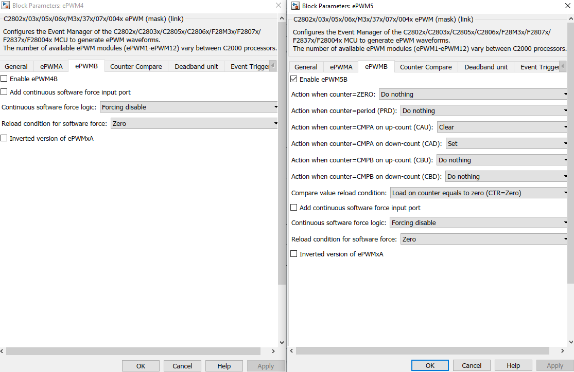

  • Hi Cody,
    Thanks for your Reply. The noise after download the model(code) i thought from MOSFETs, the circuit was short circut as the below picture shows. if i didn't push the "Reset" buttom on the board, the board will be Burnout, and must new board to use.
    And now i used just 20V as power circuitry. As you said, i have already enabled the Deadband, but it can't realise the function of sPWM in H-Bridge.
    So i test the 2 Half-Bridge ePWM4A/B and ePWM5A/B separately with Deadband, and 2 MOSFETS by the Control from ePWM Block operate normally.
    After i knew how to use the deadband in order to make the alternating complementary control Signals to ePWM4A and to ePWM4B. For the ePWM5A/B the Control Signal is inverted to ePWM4A/B after synchronization between 2 ePWM blocks. So the source of "RED" and "FED" for ePWM4 are both from ePWM4A, but the source of "RED" and "FED" for ePWM5 are both from ePWM5B. the reason for the choice in order to switch on and off the 4A/5B and 4B/5A in H-Bridge.
    The Parameter Adjustment of ePWM4 and ePWM5 as below Pic.
    But when i connect the OUTPUT1 and OUTPUT2 with resistor as Picture1. there is no Signal between two sides of resistor in oscilloscope. the Signal in Pic.2 cant realise, although theoretically right. so i thought Maybe the  synchronization Problem. so i connect 2 resistors seperatly between OUTPUT1 to GND and OUTPUT2 to GND in oder to see, whether the Signal PWM Output are complementary. but after test, the two Signals from OUTPUT1 and OUTPUT2 are exactly same, so it means, 4A/5A switch on and off at the same time and 4B/5B switch on and off at the same time. but they should not.
    i have already tried adjust the Control Signal to gate or a "Phase value" to delay the counter of ePWM5. but i can't figure it out, how can i realise the foundamental function of Pic 2. Is it the Problem of Synchronization? or anything else.
    Yansong

  • Hi Cody,
    Thanks for your help. I have already figured it out. I used 2 Half-Bridges to combine one H-Bridge (4 ePWM and 5 ePWM). It's worked.
    Yansong
