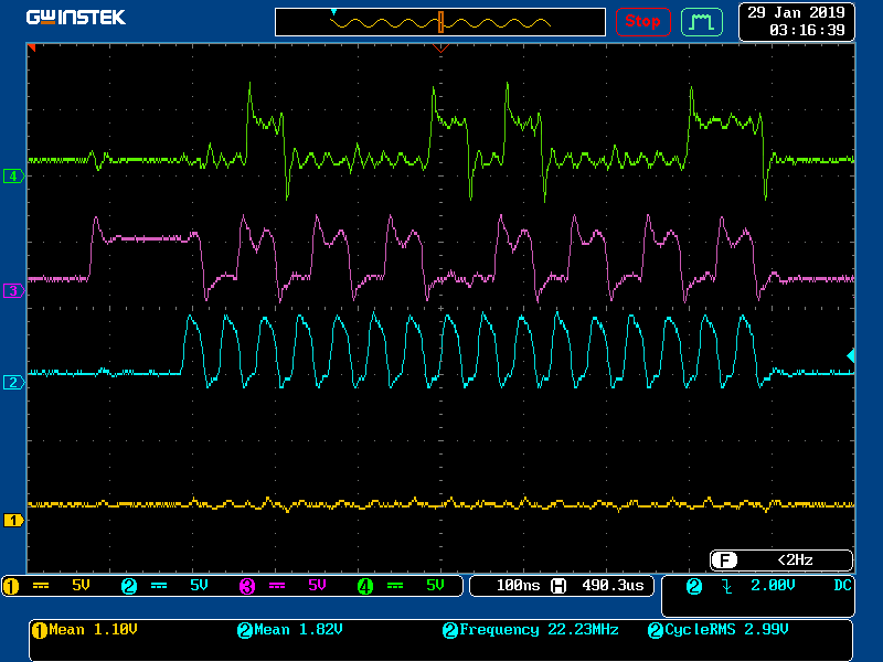

The error is that there is an extra bit inserted at the front of the data transfer that is not seen in the actual data transfer. The data received is 0x10a1 rather than the transmitted data 0x2143. Note that 0x10a1 == (0x2143 >> 1).
I am attaching an oscilloscope capture of the trace as seen on the SPI lines. The signals from top to bottom are SIMO (green) clocking in the bit pattern 0010-0001-0100-0011 (0x2143), SOMI (purple) clocking out the bit pattern 1010-1010-0101-0101 (0xaa55), SCLK (blue), and SCS (yellow) which is low throughout the transfer.

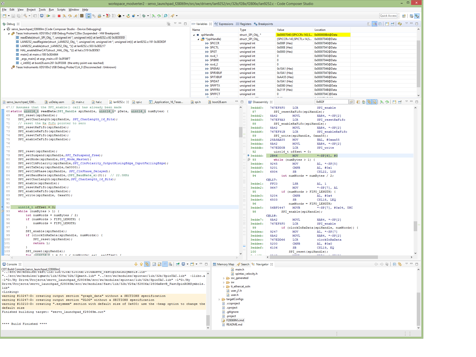

The SPI configuration is shown in the next screen capture which shows the setup and transfer code as well as the SPI registers immediately following the transfer. I am configuring the clock to capture input data on the rising edge of the clock Polarity=0, Phase=1.

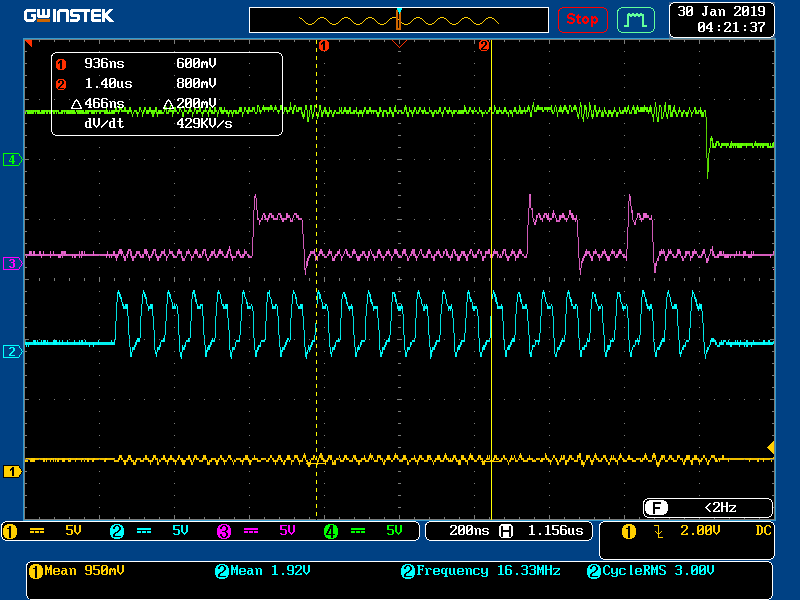

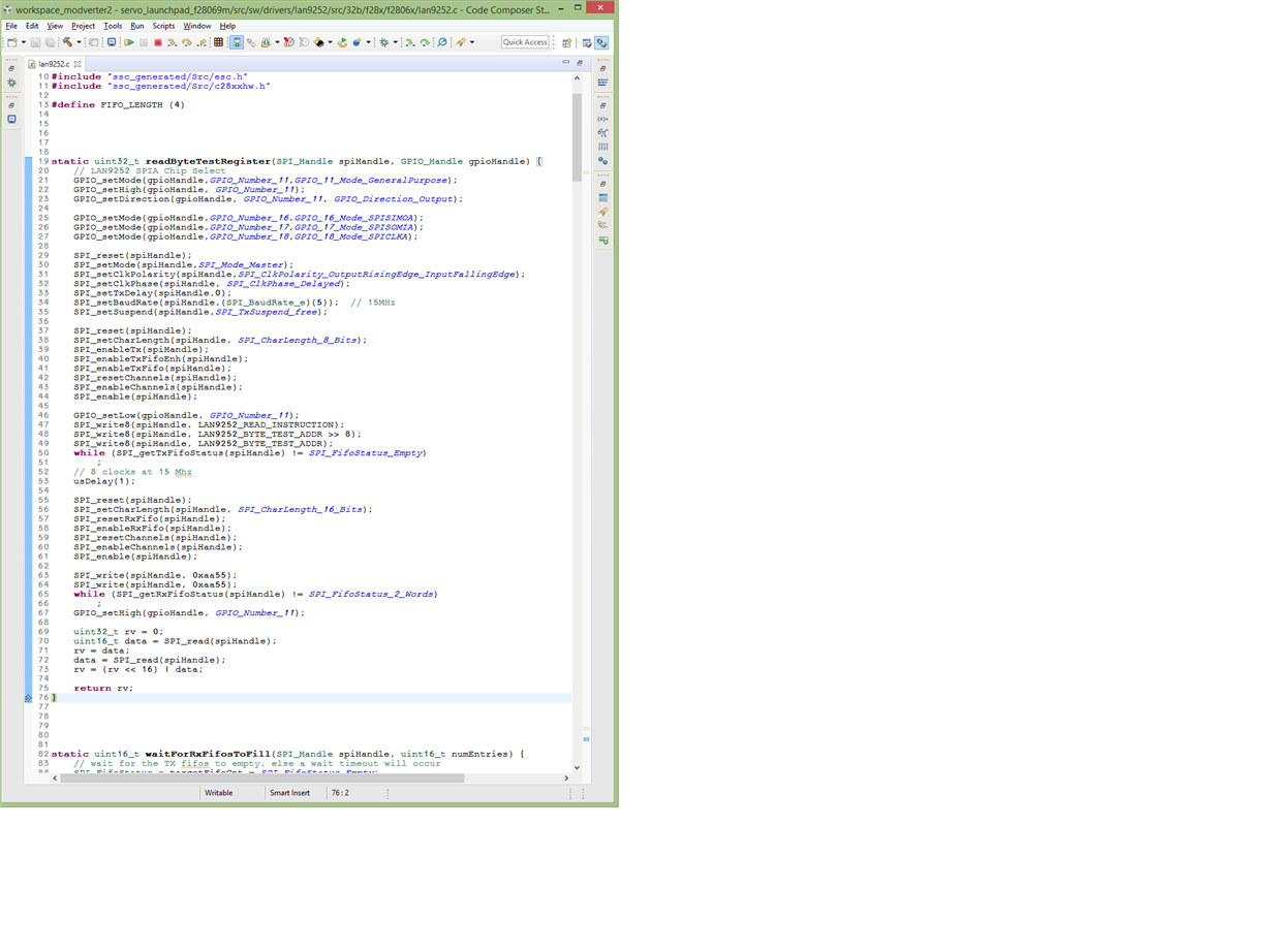

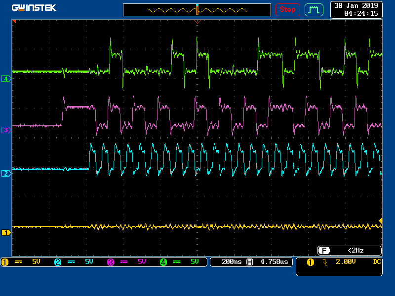

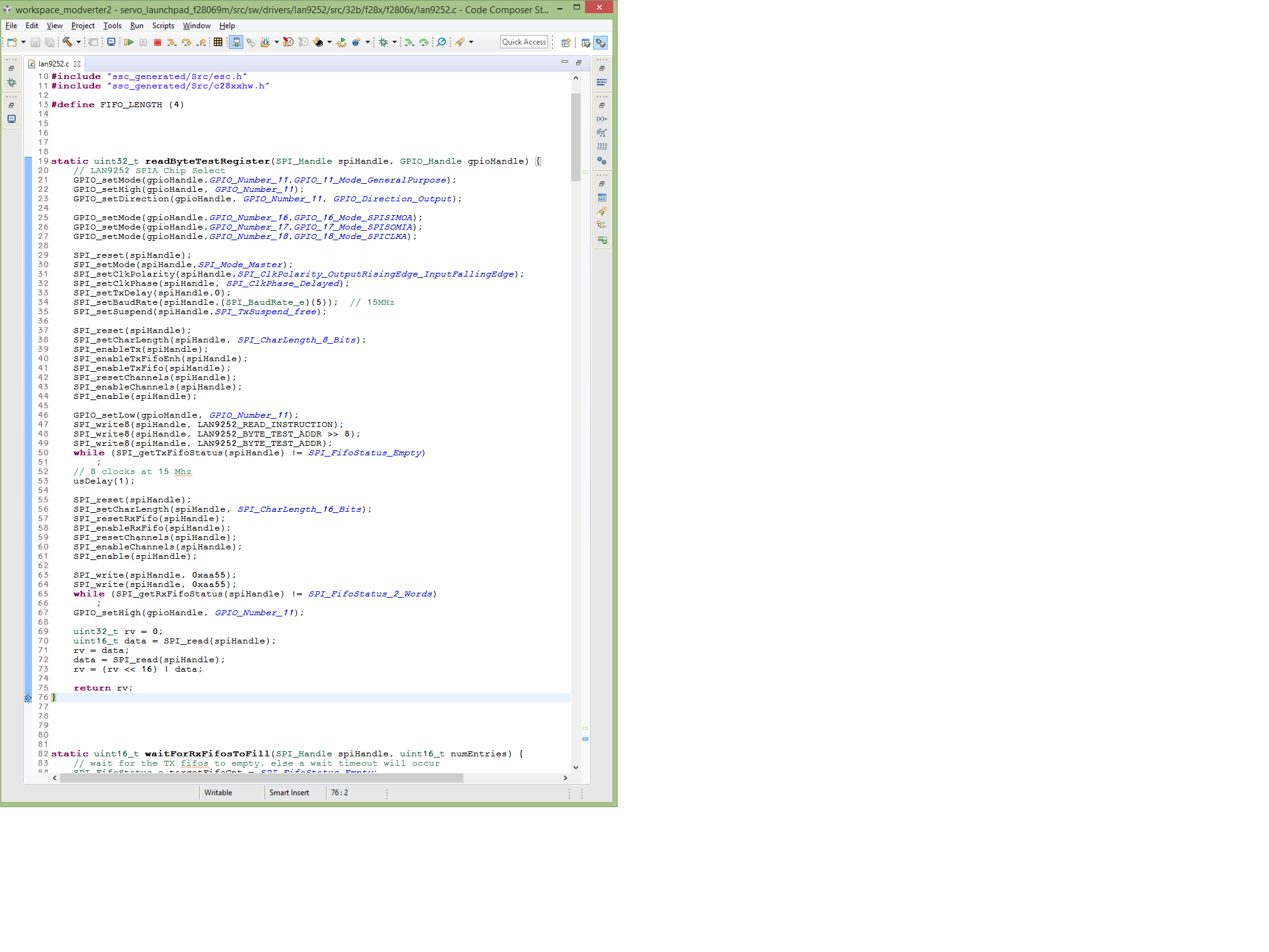

    I have rewritten the code into a single function below so that you can see the entire GPIO/SPI configuration and the transfer. The traces below are generated by this code. As you can see, the CS* line never rises and there are no extra clocks. The received value from the code is 0x10A1B2C3 which is the transferred value of 0x21436587 >> 1.
    The transfer consists of the Master sending three bytes: 0x03 for a Read; 0x00 as high byte register address; 0x64 as low byte; In response the slave sends the response 0x21436587 (00100001 01000011 01100101 10000111). All of this can be seen in the traces below.
    Complete transfer
    Read Command and Address (0x03, 0x00, 0x64) zoomed in
    Response data as 8-bit transfers (0x21, 0x43, 0x65, 0x87) zoomed in
    Initial part of Response data zoomed in

    Though you are reconfiguring the SPI word length mid-transaction, you are doing it properly by putting the module in reset, changing config, then re-enabling. Personally, i would just keep it all in an 8-bit word format, but again, the way you are doing this is correct.
    Your SPI configuration is "Rising Edge with Delay" which by the TRM definition is " The SPI transmits data one half-cycle ahead of the rising edge of the SPICLK signal and receives data on the rising edge of the SPICLK signal."Tracing this out on the scope captures shows that you see both the SIMO data (purple) and SOMI data (green) changing on the falling edge (half cycle ahead). The SPI will sample the SOMI line on the rising edge. SPISTE is toggling appropriately, and there are no extra clocks. This all appears to line up correctly.

    I did as you requested. The NOPs and the 8-bit transfers had no effect. Then I tried running the code on the 28027F and got the same failure, an extra bit shifted in ahead of the true bits.
    I was then able to track it down to the SPIBRR, baud rate register. On the 28027F the transfer fails when the SPIBRR is assigned a value of 5 or less. On the 28069M the failures occur at values of 9 and below. (Thankfully I wasn't using values of 6, 7, 8, or 9 on the 28069M or the code that failed on the 28069M would have run on the 28027F successfully!)
