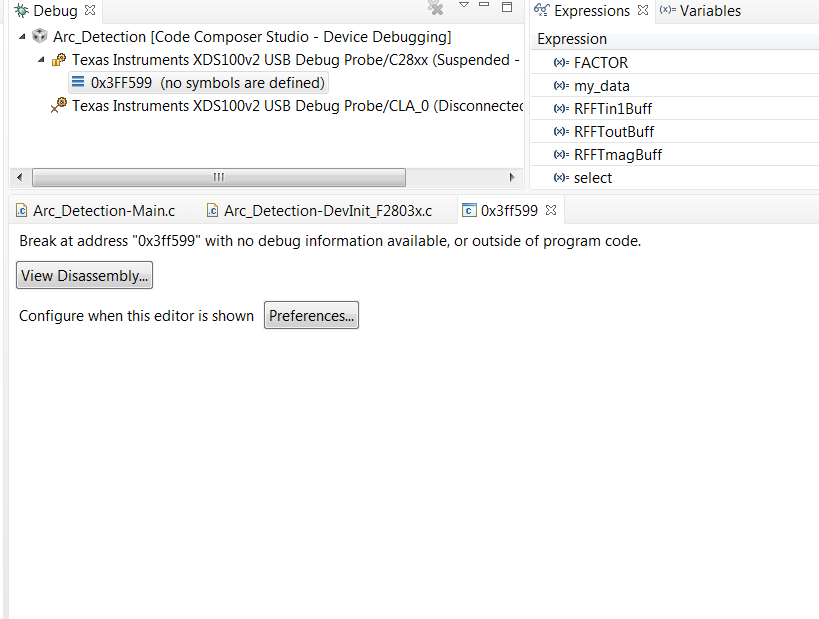

when i started debugging code in CCS debugging stopped with following error
when i has analyzed it following function call is genrating this ESTOP.
i did not understand why this function is going to generate this error. please help to solve this issue
  • Vishal,
    I'm not sure why the code would be stopping in this area; the Device_cal function should be inside TI OTP in the 0x3D7EB0 range. The address you are referring to 0x3FF599 is near the end of boot ROM for this device, which is open. If the Boot ROM symbols aren't included in your project there would not be source code..
    If you could put a BP at the Device_cal function, and then use the assembly single step to bring up the dis-assembly when the function is called I can see if the OTP appears OK. I beleive it is 2 register writes then a return back to the code.
    Matthew

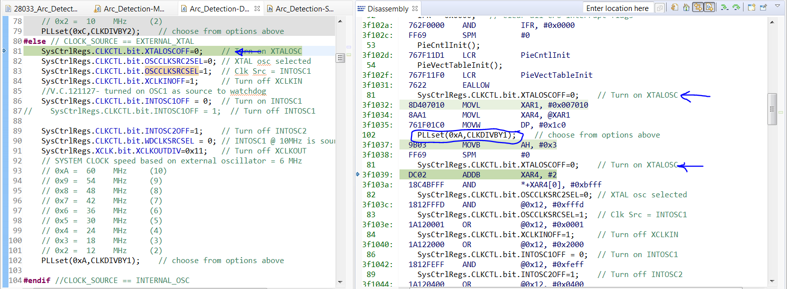

  • hello sir,
    when i tried to put break point at  Device_cal function  and then i pressed run button but what i found is that it is showing same error what i has previously mentioned ,and one thing i found is that when i am doing step by step running at that instant code run fine but when it reaches to  Device_cal  function it breaks and then starts again when i pressed step by step running button .
    i has observed following thing
    when following instruction is executed
     SysCtrlRegs.CLKCTL.bit.XTALOSCOFF=0;
    why it jumps to
      PLLset(0xA,CLKDIVBY1);
    when i see disassembly following line is found.  PLLset function next to extranal oscillator off .
    i want to know is it ok??
    regards,
    vishal.
  • Vishal,
    This is OK, this design has an external crystal Y1 that is populated on the PCB.
    For the earlier experiment it is important that we see the contents of the dis-assembly when we step into the Device_cal() function. If you are halted at the Device_cal() function use Ctrl+Shift+F5 to assembly step into.
    If CCS is giving an error, or blocking this area from view then we need to modify the memory map to allow it. You can make sure the GEL is correct by selecting "Tools" GEL file from the top menu. It should have the GEL file that matches the device(F28033). If it doesn't you can load the GEL from here: C:\ti\ccsv8\ccs_base\emulation\gel\f28033.gel
    I want to make sure that the device_cal is correct, assuming that is still where the code is stopped.
    Matt

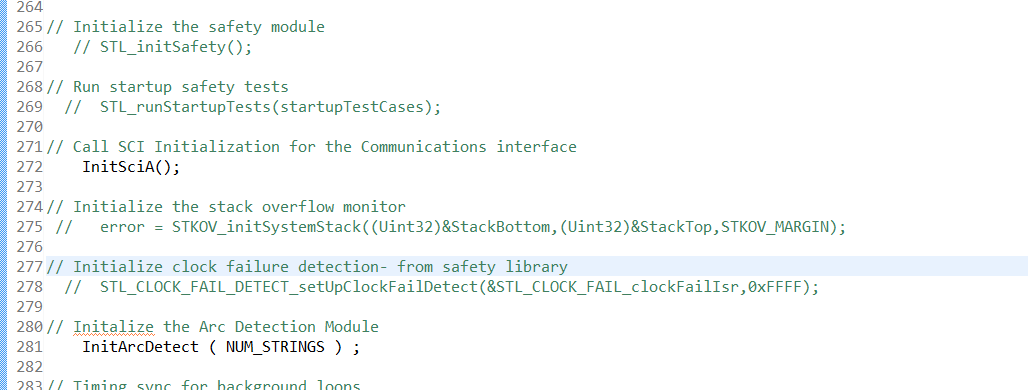

    i has done two thing and everything is working fine, yellow LED is blinking and green LED is continuously on. but when i has tried to generate software based arc it is not detecting arc so why it is behaving like that..?
     1.when i has commented STL test  everything is working fine , is it ok can i bypass STL test.?
    i has attached snap shot of following
    can i do like that ?
    2.i has selected internal crystal oscillator instead of external crystal is it ok??
    please provide your feedback.
    thanks & regards,
    vishal.
  • Vishal,
    If you right click on the project, scroll down to Build Configurations and "Set Active" Since you have disabled/don't want the STL I think you need to choose "Debug" vs the Flash standalone. This should effectively removal all the safety library calls since you have disabled the watchdog.

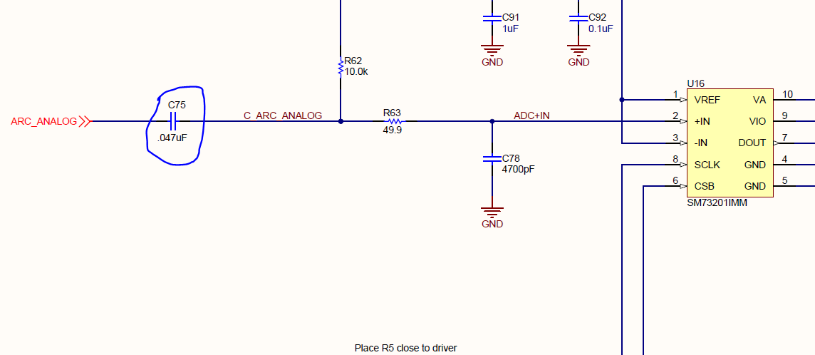

  • SIR,
    THANKS FOR REPLY.
    sir my code is working. . when i has PRESSED switch (SW1) and probed at TEST POINT (TP17) ARC is generating so it is OK.
    SIR,
    THANKS FOR REPLY.
    but when i measure same signal after CAPACITOR (C75)  it is not transferring to ADC pin
    what i have done is, i has removed this capacitor (C75) and i am sure that i has already R63 AND C78 RC filter is available on ADC pin so i would not pic up a noise.
    now i did not understand why this capacitor needed to be removed.?
    what happen if actual ARC is generating then i needed the this capacitor?
