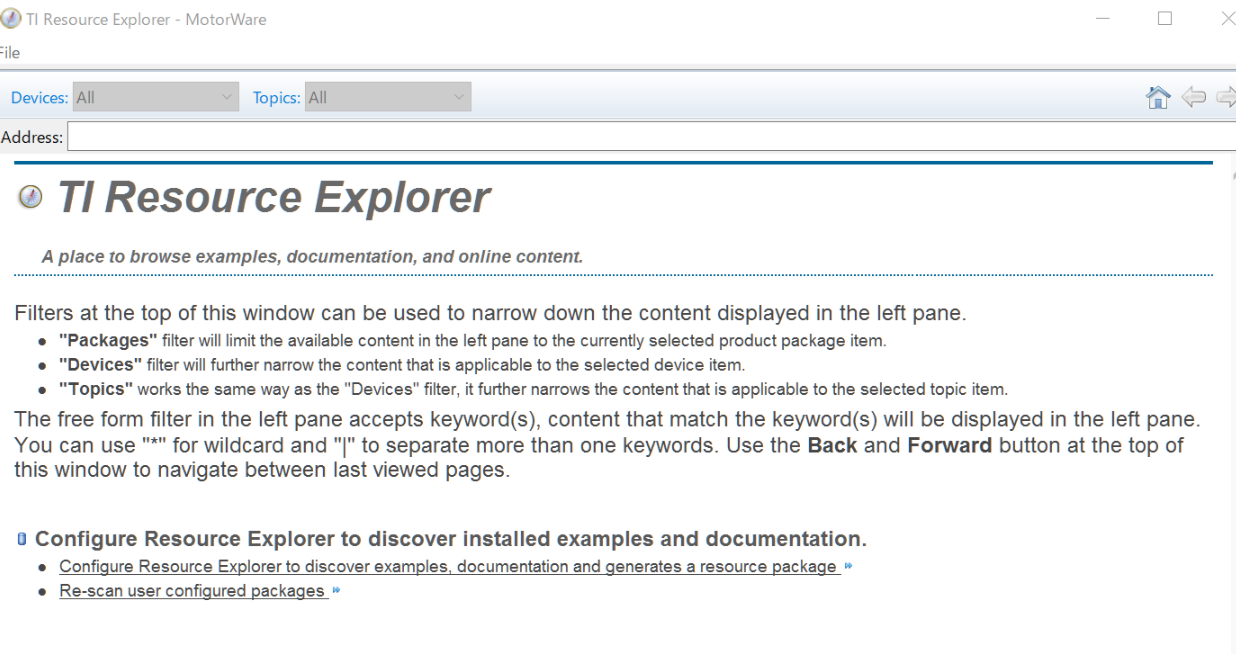

We want to operate InstaSpin motor control by using BOOSTXL-DRV8305 and TMS320F28027F.
I started MotorWare in local PC, but the GUI can not be clicked at all.
The MotorWare directory is installed at local PC(Windows10 64b)  as name of motorware_1_01_00_18.
I attached image of MotorWare GUI when I execute MotorWare.
Do you have solution?
BestRegards
  • We see this happen occasionally with the Motorware GUI, and we primarily ask that you 1) delete the .metadata folder in C:\ti\motorware\motorware_1_01_00_18\eclipse\workspace, and 2) try reinstalling if (1) doesn't work. You can also access all of the files and examples through the Windows explorer; for instance, the InstaSPIN lab guide to start working with the example labs is located here: C:\ti\motorware\motorware_1_01_00_18\docs\labs
