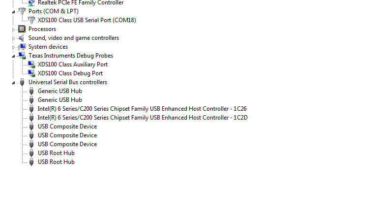

  • Hi Brett,
    Thanks for your valuable input,
    Yes it displays "Texas Instruments Debug Probes" in device manager attached image file for reference.
    I tried with re plugging USB cable and also restart my laptop but not working.
    My second Docking station is working fine and also LD1 LED is getting powered on.
    My program is also running fine in controller board but only issue is with the docking station regarding programming.
    Jignesh Patel

  • Hi Jignesh,
    Unfortunately, the only thing I can conclude is that the FTDI chip U1 (or U4) got damaged from ESD (or some other similar occurrence).  Or potentially that J1 is damaged (or feasibly J2).
    As a result, I think you will need to buy a replacement kit.  Note that we do not sell the DIM100 Docking Station all by itself, only as a part of an Experimenter's Kit.
    • U1, and most of its surrounding circuitry, works because the FTDI can be reprogrammed using MPROG
    • Your CCS installation, target configuration, and drivers are working since the other identical kit works
    • The controlCARD is not the issue, since that controlCARD works when put on the other Docking Station
    • This means the issue has to be between the FTDI U1 and the controlCARD interface at J1
    I'm sorry that I don't have better news.
