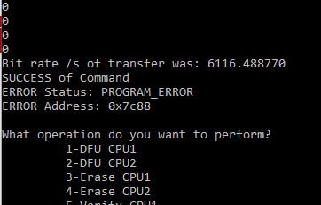

I have problem with using serial flash programmer to upload the firmware for F28379D. When I tried to upload the firmware with C2prog using SCI, it funktioned. But there's an error by serial flash programmer.

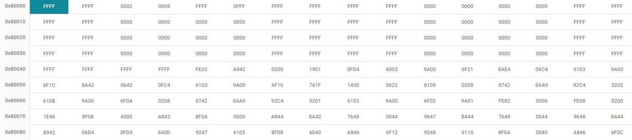

I checked the flash with the uniflash. Then I found that the data in flash (0x80000 to 0x80041) isn’t uploaded correctly. Somehow 4 words always get lost.
Can you suggest me what’s wrong? Maybe the flash is parted? Because I divide the flash A into 4 parts.
Thank you for your support in advance.
Best regards.
    You can see in the command window what is returned. It is returning an error address of 0x7C88. This is RAM. You might have some code loading to RAM in your hex file. The SCI flash kernel will not program this directly. This is likely an issue with your CCS project and loading your entire application to RAM.
    Hope this helps. Use the error messages to help you debug this.
    sal

    Do you have any code loading to RAM? The error address is to RAM, and the kernel is unable to program RAM. Make sure your entire application is linked to load to flash.

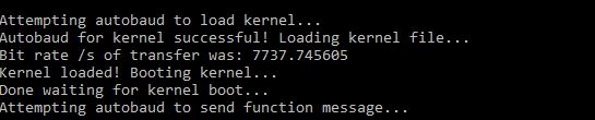

  • I use the files in example projects.
    The command for running the application:
    -d f2837xD -k C:\ti\c2000\C2000Ware_1_00_06_00\device_support\f2837xd\examples\dual\F2837xD_sci_flash_kernels\cpu01\ccs\CPU1_RAM\F2837xD_sci_flash_kernels_cpu01.txt -a C:\ti\c2000\C2000Ware_1_00_06_00\device_support\f2837xd\examples\dual\blinky_dc\cpu01\ccs\CPU1_FLASH_STANDALONE\blinky_dc_cpu01.txt -m C:\ti\c2000\C2000Ware_1_00_06_00\device_support\f2837xd\examples\dual\F2837xD_sci_flash_kernels\cpu02\ccs\CPU2_RAM\F2837xD_sci_flash_kernels_cpu02.txt -n C:\ti\c2000\C2000Ware_1_00_06_00\device_support\f2837xd\examples\dual\blinky_dc\cpu02\ccs\CPU2_FLASH\blinky_dc_cpu02.txt -p COM4 -v
    1. The application serial flash programmer started and downloaded the kernel file of CPU1 completely.
    2. Then I put in "1" for "DFU CPU1". The firmware was also downloaded successfully.
    3. Now I put in "13" for "Run CPU1 and Boot CPU2" to download the kernel file of CPU2 and "0x00000000", "0x00080000" and "0x00082e71" for adresse to branch to.
    4. The programm downloaded the kernel file and always hung at "Attempting autobaud to send function message..."
    I don't know what I did wrong.

  • Yes, we have tested this.
    Can you confirm that the CPU1 kernel you built was with the DUAL configuration. The kernel has 2 build configurations. One which supports only CPU1 and one which supports dual DFU.
    Please rebuild the CPU1 kernel with the DUAL build configuration and begin to debug this yourself and come back with some more specific questions. Then I can help you better.
    Also, address 0x00000000 is not a correct branch address.
    sal
