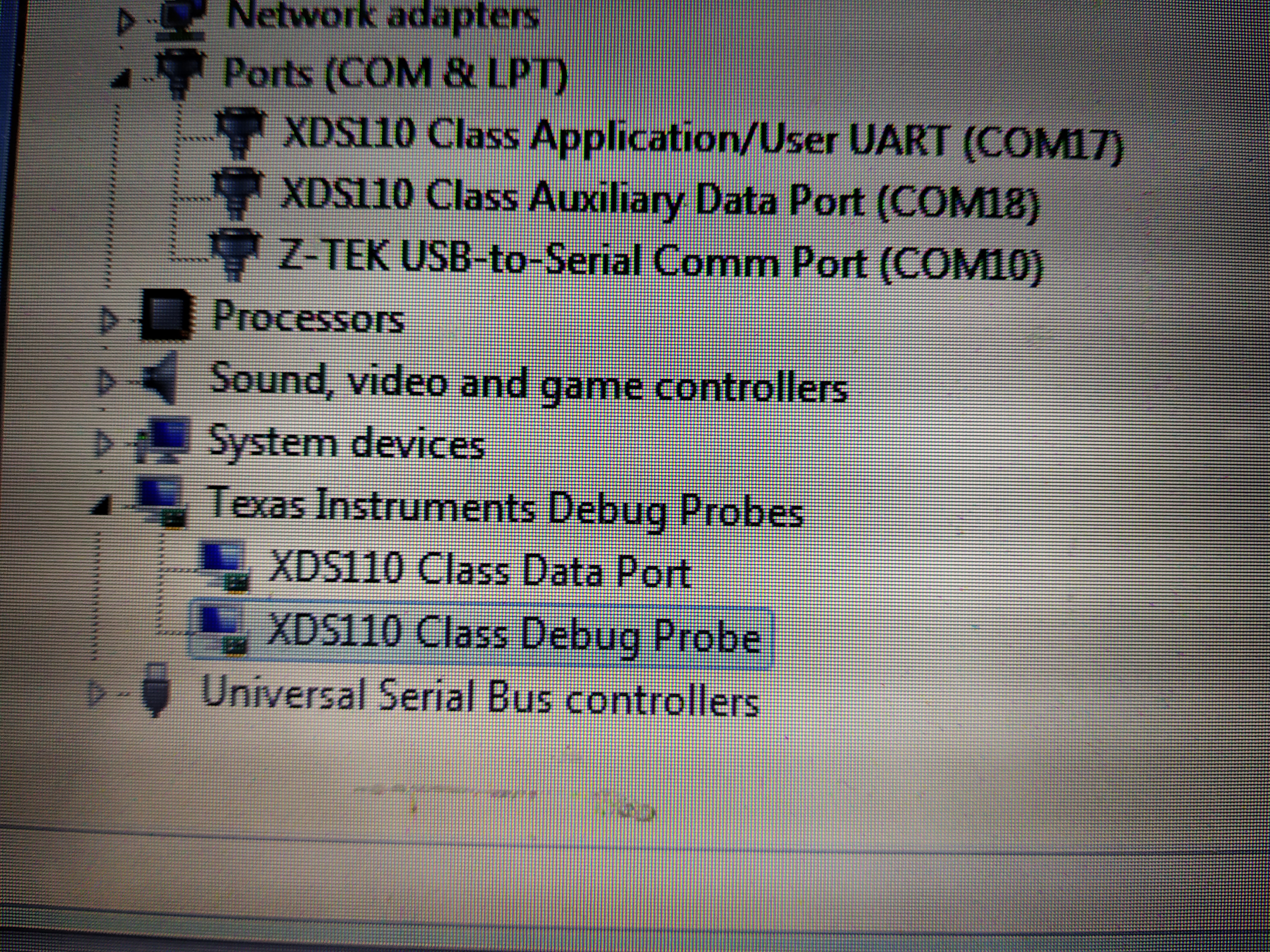

Recently we bought TMDSEMU110-U to debug TMS320F28377DZWT DSP. But we dont have driver to debug the same using CCF uniflash.
Can anyone help me to find the driver for debugging this DSP using cc uniflash.
Image of usb device showing in device manager while connecting specified part no:TMDSEMU110-U attcahed
  • Mebin,
    I have not used the TMDSEMU110-U debug probe before, but based on your screenshot, it looks like the XDS100 Debug probe driver is already installed.
    In UniFlash, you should be able to select your device (TMS320F28377D) and connection (Texas Instruments XDS110 USB Debug Probe) and then start. UniFlash should then be configure to communicate to your device for flash programming or other operations.
    Can you see if this works for you? Also note that UniFlash does not provide debugging functionality, so if you need to debug your application, you should look at Code Composer Studio instead.
