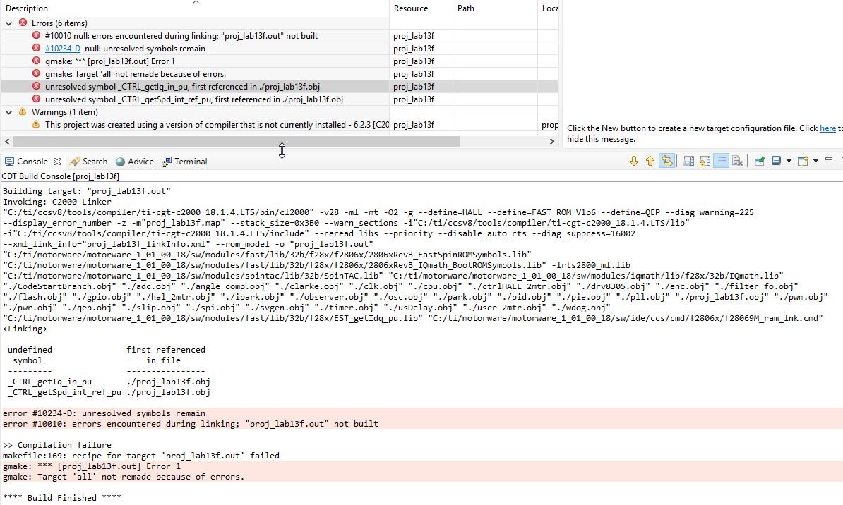

I am having problem building/linking my modified 13f lab. The description is:

Please any help appreciated.
Since the CTRL_getSpd_int_ref_pu() and CTRL_getIq_in_pu() are definded with "inline" in header file, why did you have below codes in the .c file? You might remove these two lines code.
_iq CTRL_getSpd_int_ref_pu();
_iq CTRL_getIq_in_pu();
