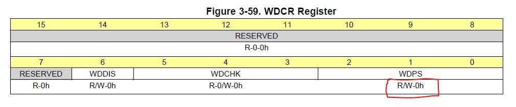

  • Correct, this is the designed behaviour. On reset, the watchdog is enabled and WDPS is zero (i.e. watchdog timer clocked at slowest rate - see the reset values in the WDCR register description on p. 223 of the TRM). This obliges the user to reset or configure the watchdog after each reset. There's no way to change that.

  • Hello Ashish,
    On reset the device registers are automatically initialized in hardware with the values shown in the reference guide.  User code plays no part in this.  For the WDCR register, all the bits are set to zero (see the attachment).  Any register values loaded previously will be lost on reset, so your code needs to re-initialize the watchdog after each reset or power-up.
    Can you give me a little background on why this is a concern?
    Richard

  • Hi Ashish,
    After WD reset, most of the register in device get reset to their default state. This default state is mentioned in the device TRM (see below the snapshot).
    Default value of the WD prescaler is 0x0 hence after reset when application re-start the value will be 0x0 unless SW  write to this field again. If you want new value to take effect from starting of your application then you need to move the code which initialize the WD prescaler into "xxxx_CodeStartBranch.asm".
