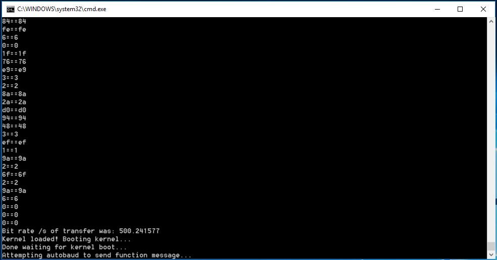

  • Hello Chris,
    Thanks for your reply.
    I have tried to program CPU1 with "serial_flash_programmer.exe" but, most times, it gets stuck after releasing the "Attempting autobaud to send function message..." message:
    Then i I suspend CPU1 execution in CCS I can see it is executing the following code, looping from address 0x00cdcb to 0x00cdc7::
    Can you give me a hint on what the problem could be?
    Andreu

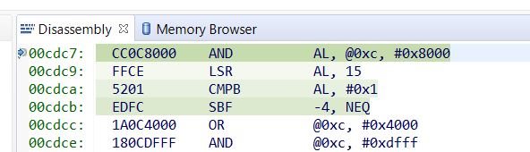

  • Chris,
    I have found where the kernel in CPU1 gets stuck at: Line 385 in module Shared_Boot.c, you can see the disassembly on the right. Anyway, there is a previous error at function Assign_SCIA_IO_CPU2 of the same module: Attempted to read past the end of memory at 0xFFFFFFFF...
    I cannot understand why it is executing function Assign_SCIA_IO_CPU2 when it has not even loaded the CPU1 code in CPU1 Flash yet. I mean, shouldn't it program CPU1 flash before assigning SCIA to CPU2?
    What do you think it is happening?
    Andreu
  • Andreu
    There looks to be a misalignment with the symbols and the code. I tracked down the disassembly and you're actually stuck in the SCIA_AutobaudLock function in SCI_GetFunction.c. Ignore the CPU2 stuff, since it is inaccurate. Those are only run once you give the kernel the command to boot CPU2 to load CPU2's kernel, etc.
    I'm not sure which HEX files you are using, but I suggest, rebuilding the HEX using the SCI kernel project in C2000Ware under device_support\f2837xd\examples\dual\F2837xD_sci_flash_kernels (Make sure to confirm the kernel is setup to use your SCI GPIOs). Make sure to not open up the HEX files since windows text editors will add junk into it.
    Since the issue is autobaud lock, it is either a GPIO issue or a timing issue.
    Best regards
    Chris

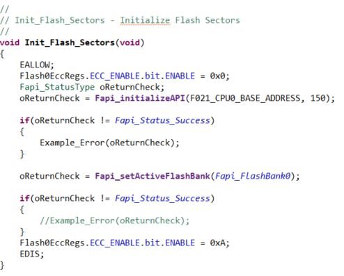

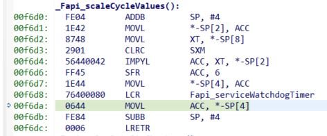

  • Chris,
    I have been testing more and I have seen that the Illegal Intruction Itrap is triggered when excuting expression:
    oReturnCheck = Fapi_setActiveFlashBank(Fapi_FlashBank0);
    in function Init_Flash_Sectors (CPU2 Kernel):
    A have look for this kind of issue in the C2000 Forum and I have found some problems related to Fapi_setActiveFlashBank function:
    https://e2e.ti.com/support/microcontrollers/c2000/f/171/t/572428?TMS320F28377D-Flash-API-hangs-on-Flash-Fapi-setActiveFlashBank-execution
    https://e2e.ti.com/support/microcontrollers/c2000/f/171/t/651633?CCS-TMS320F28377D-Fapi-setActiveFlashBank-execution-crashes
    Why is a NMI (due to double bit errors) occurring when Fapi_setActiveFlashBank() is called on F2837xD CPU2? at:
    http://processors.wiki.ti.com/index.php/C2000_Flash_FAQ
    Why does application end up in illegal ISR when using Flash API? at http://processors.wiki.ti.com/index.php/Flash_FAQ
    But I could not see what my problem is.
    As I have read that some early devices had some problems related to ECC, I must tell you that I am testing this on a F2837x controlCARD R1.1 where the DCU device is a TMX320F28377D.
    Could you help me with this?
    Andreu

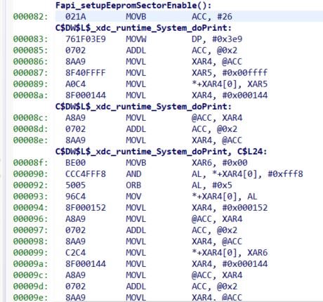

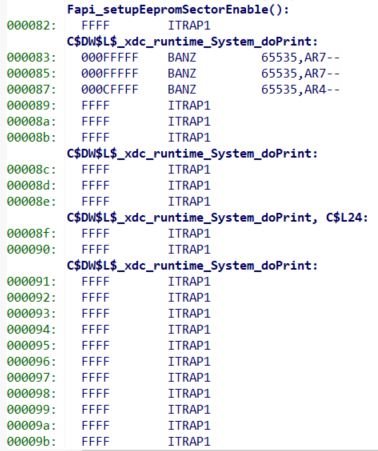

  • Hi Sal,
    Many thanks for your answer. Here you have mines:
    1) Can you confirm that CPU1 has reliquish the flash pump and CPU2 has seized it? Yes, I managed to trace it.
    2) Have you gotten CPU2 kernel working when loading via CCS? Is this just an issue when doing this from standalone?  I could not get it working because execution of address 0xF5E5 triggered c2brom_itrap_isr.
    Anyway, if I a watch Disassembly in RAM memory I can see differences between the kernel loaded by CCS and the one loaded through serial_flash_programmer application. For instance, when using CCS, address 0x0082 looks like this:
     But if load the kernel through the serial_flash_programmer application, it looks like this:
    So, there is an ITRAP instruction in address 0x0082 and that must be the reason why CPU2 execution always jumps to c2brom_itrap_isr.
    I cannot understand it. What can be wrong? I have attached my F2837xD_sci_flash_kernels_cpu02.txt file so you can check whether there is a problem with it or not....
    Many thanks in advance,
    Andreu

  • Does the kernel try to execute that opcode? Can you set a breakpoint and see why and when this is trying to be executed?
    I am not sure why this is needed even for what we are doing with the Flash API.
    sal
  • Hi Sal,
    Yes, kernel tries to execute it and, then the Illegal Intruction Itrap is triggered. This happens in several parts of the code. It also happens when executing SETC OBJMODE in wd_disable
    * Function: wd_disable

    Can you try to find the block of memory in the hex file that illegal instruction is in? It would be good to see if the opcode is in the hex file but just not being programmed, which would be strange.
    This may be an issue with the hex file somehow not including this instruction. Can you try moving the section or linking the function to a different location and see if this fixes the issue?
    sal
  • Hi Sal,
    Many thanks for your answer. I have moved the .TI.ramfunc section from RAMM0 to RAMD0 in the flash_programming_cpu2_RAM.cmd file:
    Original Setting
    #ifdef __TI_COMPILER_VERSION__
        #if __TI_COMPILER_VERSION__ >= 15009000
           .TI.ramfunc      : > RAMM0      PAGE = 0
        #else
           ramfuncs         : > RAMM0      PAGE = 0
        #endif
    #endif
    New Setting
           .TI.ramfunc      : > RAMD0      PAGE = 0
        #else
           ramfuncs         : > RAMD0      PAGE = 0
        #endif
    #endif
    Now it works, so I can program both CPUs and make them run. Have you got any idea, about what the problem can be?

  • Hi Andreu,
    The issue may be that the boot ROM uses RAMM0 for stack and local variables when the boot ROM code is executing.
    I suspect that the ROM code is overwriting the memory location that is being programmed by the bootloader, so that the value (opcode) may be getting loaded, but it is getting overwritten by the ROM. Now, you have the code being loaded somewhere else which is not being overwritten by the ROM.
    This is my best guess given the behavior. Glad you got it working.
    sal
  • Sal,
    Does it mean, then, that the project in C2000Ware_1_00_06_00\device_support\f2837xd\examples\dual\F2837xD_sci_flash_kernels\cpu02 is wrong?
    Andreu
  • It appears so. I will file a bug for this to be fixed.
