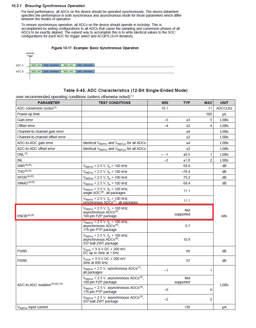

I am using TMS320F2837S controller 100pin package. I have total 14 Analog inputs, 7 for each ADC Core (A and B). In that for one analog channel I need more acquisation window. For rest of the channels I have used 140nS acquisation window, for one channel in ADC A core I used 900nS Acquisation window. So, synchronous operation is not possible.  I have tested 140nS aquisation is sufficient and works fine for remaining channels. In datasheet, for 375S 100 Pin 12 bit ADC, in ENOB value, mentioned not supported.
1. Why the limitation is only in 100 pin version?
2. What happens if I go for asynchronous operation in 100 pin package of 375S controller?
3. What happens if there is slight difference (<1 uS) between 2 ADC cores conversion?

    1+2) The performance degrades due to the specific configuration of the ADC high and low reference pins in this package if the ADCs are operating asynchronously. Here 'not supported' means that the performance is quite bad and/or not fully characterized.
    3) Any delta in timing where the ADCs are not running in lock-step is a concern.
    Is the only issue that one channel on ADC-A needs a longer S+H duration? (there aren't multiple asynchronous trigger sources?) It should be possible to just increase the S+H of the corresponding SOC on ADC-B; assuming 140ns is sufficient you should not see any difference in converted value with a longer than sufficient S+H duration.
    e.g.
    ADC-A: SOC0 to SOC5: S+H = 140ns, SOC6 = 900ns
    ADC-B: SOC0 to SOC5: S+H = 140ns, SOC6 = 900ns
    (All SOCs use the same trigger)
    Or, if you want the samples for SOC0 to SOC7 on ADC-B to be evenly spaced:
    ADC-A: SOC0 = 900ns, SOC1 to SOC6: S+H = 140ns,
    ADC-B: SOC0 = 900ns, SOC1 to SOC6: S+H = 140ns,
