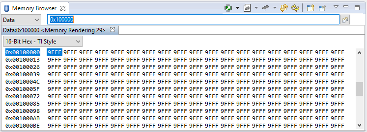

In Debug mode, I am able to view the memory browser and I cant see 0x23 in the memory location. Instead, i see this:
Any guidance?

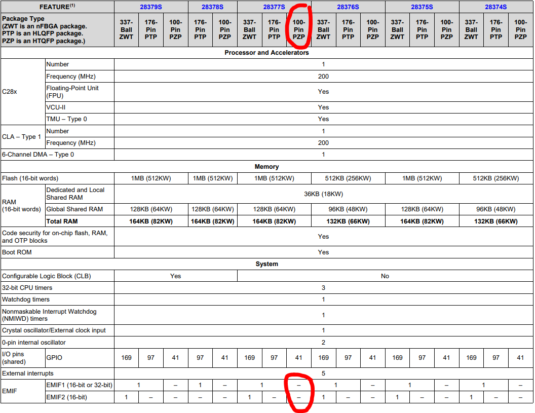

  • Tommy, Vivek,
    Yes. I actually read that over a couple of times and kept thinking that I missed a setting but I think everything is correct. To answer Vivek at the same time, I have a Digilent Board with a Spartan-7 FPGA and I used the connection that I ported from another thread and I believe that was correct as well. After a few days of combing through all the datasheets, I realize that the F28377S launchpad uses the 100-pin part [TMS320F28377SPZPT] which unfortunately does not support the EMIF (see below) even though some of the pins are labelled so. I also found another thread to confirm my findings. https://e2e.ti.com/support/microcontrollers/c2000/f/171/t/624932
     Thank you for your reply,
