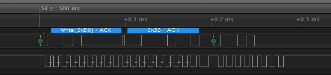

  • Hi
    Thank You for your reply
    I checked it using an logic analyzer - I did not see the effects of the code contained in this interrupt.
    I also checked it by breakpoint in  i2c_int1a_isr - the program did not stop.
    When the program ran, I checked the PIE registers:
    PIEIER8 = 0x0001
    PIEIFR8 = 0x0000
    So I write 0x0001 to PIEIFR8 and breakpoint in i2c_int1a_isr stops the program - the interruption occured.
    I2CSTR:
    When program starts:
    0001 0100 0011 0100b
    after 15 sec:
    0001 0100 0011 0110b
    for one second shows
    0001 0100 0011 0010b
    and again same as #2
    when I write 1 to PIEIFR8 and program stops at breakpoint (line 115 in the above code) inside i2c_int1a_isr :
    0000 0100 0011 0000b
  • Instead of using XRDY, try using ARDY to determine that you're ready to transmit data. Also, I see the NACK bit is getting set, but I don't see any code to handle it. Check out some of the advice on this page: processors.wiki.ti.com/.../I2C_Tips
    Whitney
  • Thank You
    Now transmission works and I can watch it on logic analyzer:
    But when I set on Run_Identify flag, BOOSTXL-DRV8301 (motor driver) turns on, and sometimes transmission break down (becouse of electromagnetic radiation/noise i think)
    And I2C_STR 0001 0100 0010 0001b
    It looks like nack bit is getting set in registry
    And looks like: External Slave Device Hanging the Bus by Holding SDA Low scenario from i2c_tips
    I want to use the solution: By configuring the I2C for "free data format" and then reading a byte the I2C will immediately start sending clocks to input data (rather than trying to send an address). This can be used to free up the bus.
    Can I use this solution in if(nack){...} interrupt? Or should I check additional conditions? (SDA low/busy)
    Is my handling-NACK code correct?
    My code:

  • That looks fine. It might be helpful to do if((IntSource == 0x2) || (I2CSTR.NACK == 1)) instead. I don't know how the ISRC register prioritizes the interrupt sources, but that might be a good way to make sure you handle the NACK first.
    Another thing to think about is that since several of the bits in I2CSTR are write-1-to-clear, the read-modify-write generated by a statement like I2caRegs.I2CSTR.bit.ARDY = 1 will clear the other status flags if they are set as well. This may not be a big deal for the way you're using them, but it's something to keep in mind.
    Is your code working reliably now? Do you need more assistance on this or can I close the thread?
    Whitney
  • Hi
    Thank You very much for help.
    I changed driver from drv8301 to drv8305 and now it works. It looks like drv8301 produces electromagnetic noises, too strong for i2c transmission.
    I will apply your tips in my project.
    You can close the thread.
