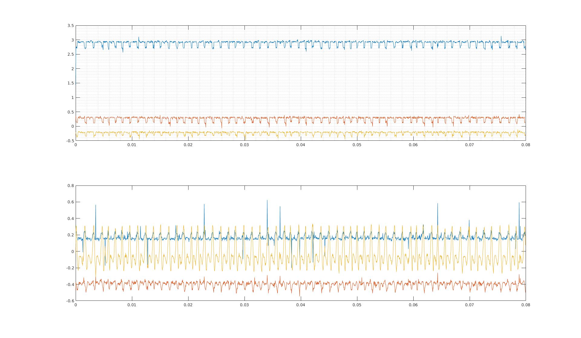

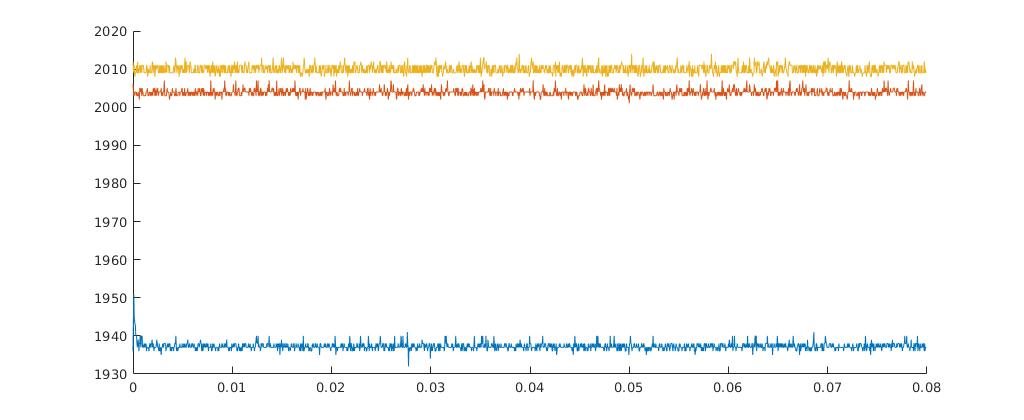

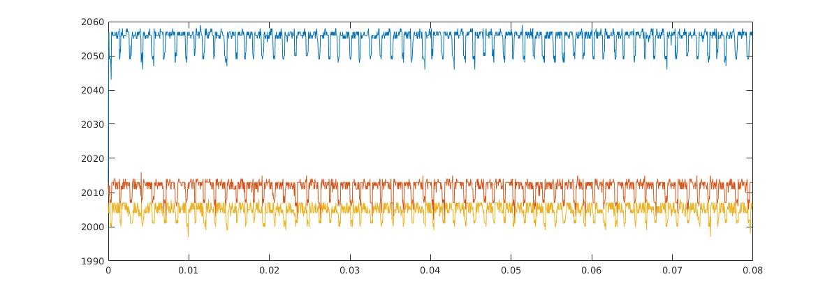

My team and i have developed a 3-phase motor controller, using the F28069 DSP.  We have some issues with approximately 1kHz periodic noise signal, which appears on the measured phase currents even if all mosfets are fully off (0% duty cycle) or fully on (100% duty cycle). To investigate this event further, we have tried measuring the phase currents with some external in-line hall effect sensors instead of the on-board low-side shunt-resistors. The 1kHz appears here as well - however not when the external sensors are connected to the ADC B group instead of the A group on the DSP.
When i sample signals using the external sensors, which are connected to ADC A4, A5 and A6 channels, an approximately 1kHz periodic noise appear.
When i connect the exact same sensors to the ADC B3, B4, B5 the problem seems to disappear.
Any ideas what could be the problem?

  • Hi Tommy,
    Thank you for answering and Sorry for missing out some important factors!
    The motor controller PCB is a custom board on which the TMS320F28069 is deployet. The in-line Hall effect sensors are located on another PCB and are connected to the DSP through a flat cable (and additional routing on the motor controller PCB)
    When i say i’m measuring the Hall effect sensors i mean that the currents are sampled from the Hall sensors using the ADC within the DSP (not a scope).
    I have not been able to detect the 1kHz by a scope as i was not able to measure that low voltages with my scope. But as the noise is not appearing when i use the ADC B’s instead of ADC A’s i figured that it must be related to the sampling and thus it should’nt occur on the analog circuits?
    The 1kHz should not have any relation to anything that i have configured in the DSP or are running on the PCB.
    The waveforms i showed in the main post was each 2000 data points stored within the DSP at a rate of 25kHz and afterwards send to my laptop and plot in Matlab where the x-axis is time and the y-axis is bits.

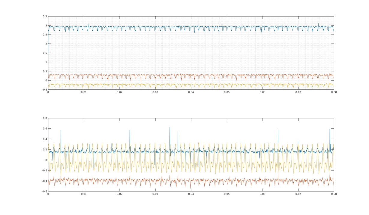

  • Hi Tommy,
    Is there noise on any of the other A channels?
    When i sample from the on-board low-side shunt resistors (using ADC A0, A1 and A2), i as well get the 1kHz noise, though it looks a bit different from when i sample from the in-line hall effect sensors (using ADC A4, A5 and A6):
     The top figure shows the phase A, phase B and phase C currents sampled from the hall effect sensor, while the bottom figure shows the phase A, phase B and phase C currents sampled from the low-side shunt resistors. The data sets entirely the same way as mentioned earlier (duty-cycle = 0%).
    So yes - i have the same problem using other of the ADC A channels.

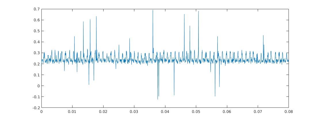

    Is the 1kHz noise still present if you replace all other ADC conversions with a single A channel like only A4 for enabled SOCs? This would reduce the residual charge impact.
    I have commented out all the lines that configured the ADCs (in initADC() showed earlier) besides from the channel A0, so that my configuration now only is:
    void InitADC() {
        InitAdc();
        // Configure ADC
        EALLOW;
        AdcRegs.ADCCTL2.bit.ADCNONOVERLAP = 1;   //Enable non-overlap mode
        AdcRegs.ADCSOC0CTL.bit.CHSEL  = 0;       //Set SOC0 channel select to ADCINA0
        AdcRegs.ADCSOC0CTL.bit.TRIGSEL = 5;
        AdcRegs.ADCSOC0CTL.bit.ACQPS  = ACQPS_VALUE;      //Set SOC0 acquisition period to 26 ADCCLK
        EDIS;
    The results again shows approx. 1kHz noise:
    And i have also tried only with A6 while leaving the ADC channel floating (nothing connected to it) which showed an approx. 1kHz noise, though not as bad:
