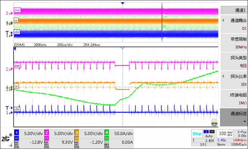

In motor Control, use spi to read position and angular datas from ADS1205.
While motor rotating, there always be a little shake. I captured the waveform when an error occurs.
The position datas will be lost in two cycles, while there is no SPICLK signal.
I tried to change baudrate from 9M to 7M, and error still occurs.
And if motor stopped, this error will never occur.
Why could this happen? And how to deal with it.
