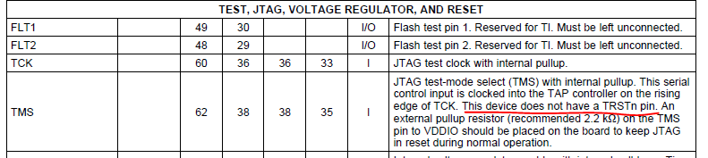

F28033 chip distinguish the Emulation Mode and the Stand-alone Mode by get the TRST Pin, but the F280049 how to do it? From the F280049 data sheet, above the picture, it doesn't have the TRST pin.

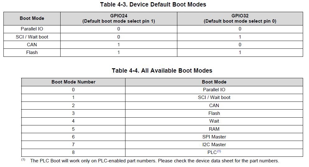

    Please refer "ROM Code and Peripheral Booting" section in device TRM  for full detail. Following is the snapshot from this section.

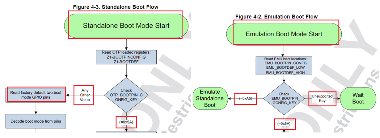

      Thank you for your reply. I had tried to get understand, but I don't find about the register you said in file detail. see the below picture. it exist in the literature number SPRUI33B.  My question is how did the F280049 get into the standalone boot or emulation boot by what?

    thanks for your reply. I have find the code you said. Now I sort out the two boot mode. when you reset the F280049, the factory boot ROM will work until judge if the debugger is connected. and by judge the  DCON bit field in the RESC register to go standalone or emulation boot. In respective boot flow, check the xxx_BOOTPIN_CONFIG_KEY value to get into the boot mode which the factory default boot mode with GPIO Pins or the user  boot mode option. that is my view, am I right?
    there are my questions below:
    1. the code judging if the debugger is connected or not, is concluded by the factory Boot ROM will do it, or the user should add this code?
    2. In the emulation boot mode, EMU_BOOTPIN_CONFIG_KEY is what default value? the emulation standalone boot is equal to the standalone boot? or is mean to get into the standalone boot?
    3. In the standalone boot mode, OTP_BOOTPIN_CONFIG_KEY is what default value? it is located in OTP place, so we only just can write the value one time?
    thanks again.
    Picture 1. choose the emulation or standalone boot mode
    Picture 2. standalone and emulation boot flow
  • Hello
    That's right
    1. This is part of the factory boot ROM code
    2. The boot configuration emulation values are stored in RAM. So by default, it will be 0. Emulation boot without any configuration of its boot values will go to wait boot.
    3. The default value is all 1s. By default, it will read the boot pins, decode the boot mode and run that. Yes, it is one time programmable. Use emulation boot to make sure you are configuring everything correctly before using the OTP boot configuration locations.
    Best regards
    Chris
