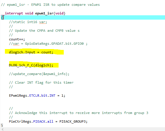

    I am doing simple PWM interupt program in that i have use the DLOG function for channel 1 as per suggested in DPLib.
    But I am not able to get the data into the buffer.

    // epwm1_isr - EPWM1 ISR to update compare values
    __interrupt void epwm1_isr(void)
        //static int16 var;
        // Update the CMPA and CMPB value s
        count++;
        //var = GpioDataRegs.GPADAT.bit.GPIO0 ;
        dlog1ch.Input = count;
        DLOG_1ch_F_C(dlog1ch);
        //update_compare(&epwm1_info);
        // Clear INT flag for this timer
        EPwm1Regs.ETCLR.bit.INT = 1;
        // Acknowledge this interrupt to receive more interrupts from group 3
        PieCtrlRegs.PIEACK.all = PIEACK_GROUP3;

  • Saurabh,
    Please use the DLOG library available in C2000Ware-DigitalPower-SDK/libraries/utilities/dlog. The API guide availble in the root of the SDK package will explain how to use the updated library. The updated library has a restructured format. Feel free to use the 4_CH buffer in your application.
    The library in controlSUITE is not up-to-date and I cannot guarantee that it will work as expected in your application.
    Additionally, are passing by reference or passign the pointer when you make the function call?
    Ozino
  • Thanks Ozino,
    I got the DLOG module example for TMS320F28379D from which I can refer.
    Thank You.
