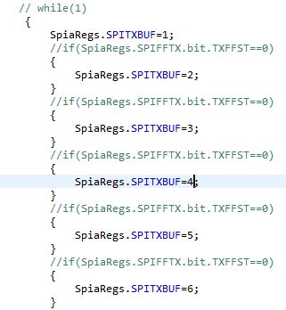

  • Hi Veena,
    I also tried it before, without if and directly wrote the six 16-bit control word into TXBUF. And I got output when I added the while(1) loop, but There were no output when I deleted the loop, That's where I am confused a lot of. I  have tried several times but there are no signals on scope, I think it should appear once and then disappear. Can you help me check with this problem?
    Jiangwei
  • Hi Jiangwei Wang,
    I am unable to reproduce the issue. I just ran the code you shared and removed the while loop and if conditions and I am able to see the data on the scope.
    I ran it own a different device, but the SPI functionality would be same.
    Veena

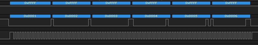

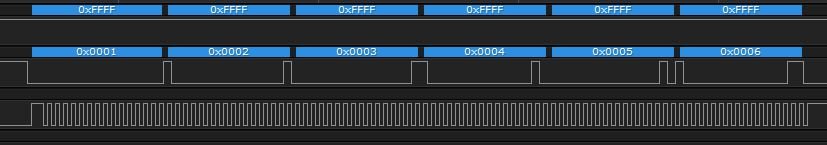

  • Dear Veena,
    Thanks a lot for the reply, I guess it's because of my scope. can you please tell me how did you get the signal? did you stop the scope once you saw the signal and use the decoder function of the scope?
    Jiangwei
    I am using Saleae Logic Analyzer. I have configured that to capture the signal for 5 seconds after a rising edge is detected on the SPI channel
    Veena
  • Hi Veena,
    Thanks a lot for the reply, I guess my question got resolved
