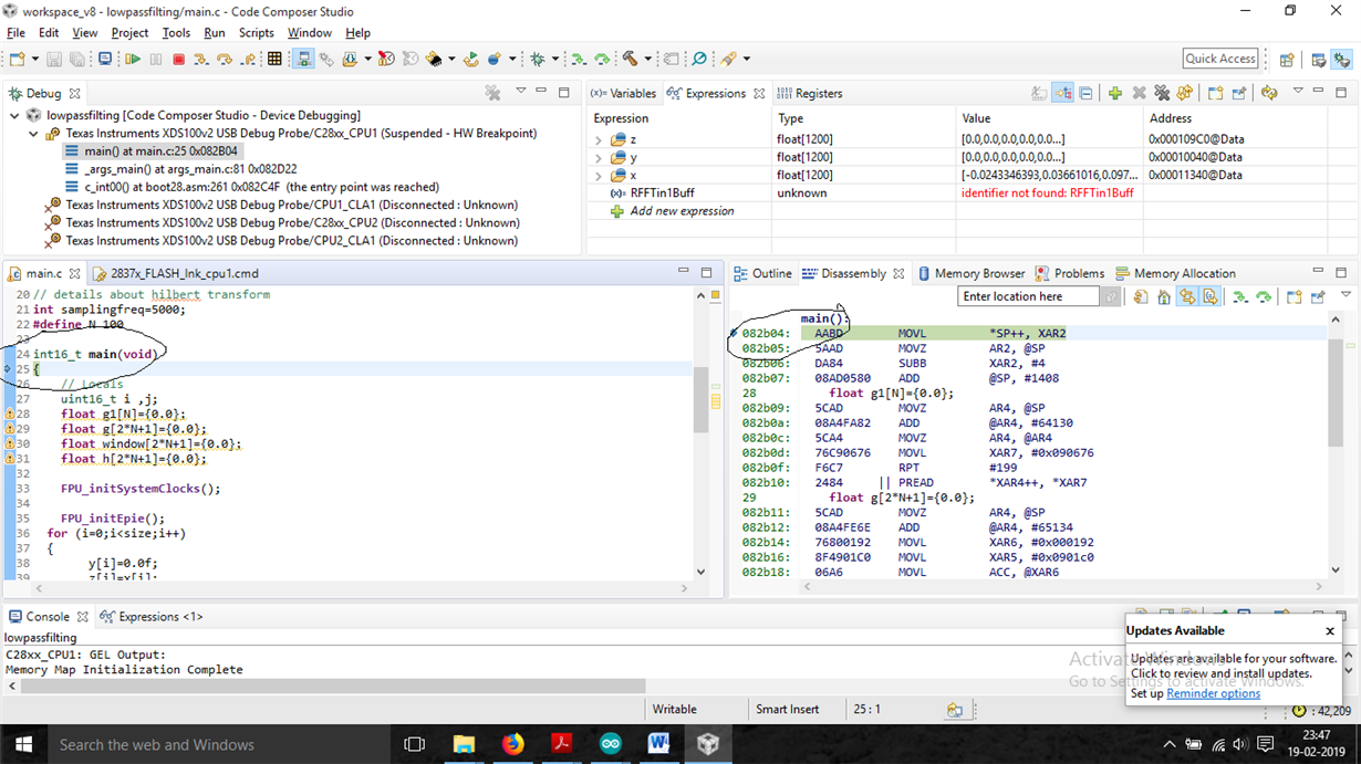

Compiler/TMS320F28379D: the program stopped inside main program without full execution of the program
Part Number: TMS320F28379D
The program is stopped at inside the main()-
// includes
#include "math.h"
#include "examples_setup.h"
#include "iir_lowpass_500_fs4267.h"
#include "nav_modified.h"
// globals
float w[NUM_SECTIONS][2] = {0.0f};
float wn,yn;
float y[size],z[size];
# define pi 3.1416
// details about hilbert transform
int samplingfreq=5000;
#define N 100
int16_t main(void)
    // Locals
    uint16_t i ,j;
    float g1[N]={0.0};
    float g[2*N+1]={0.0};
    float window[2*N+1]={0.0};
    float h[2*N+1]={0.0};
    FPU_initSystemClocks();
    FPU_initEpie();
  for (i=0;i<size;i++)
        y[i]=0.0f;
        z[i]=x[i];
      /* IIR Lowpass filter of second order */
 for(j=0; j<size; j++) {
           for(i=0;i<NUM_SECTIONS;i++)
                    wn = x[j]- a[i][0]*w[i][0]- a[i][1]*w[i][1];
                    yn = b[i][0]*wn +  b[i][1]*w[i][0]+  b[i][2]*w[i][1];
                    w[i][1] = w[i][0];
                    w[i][0] = wn;
                    x[j] = yn;
              y[j]=yn;
/* hilbert transform*/
/*for(i=0;i<=N;i++)
    float k= sin(pi*i/2);
    g1[i]=2*(k*k)/ (pi*i);
for(i=0;i<=2*N;i+1)
   if(i<N)
          g[i]=-g1[N-i];
   else
           g[i]=g1[i];
 then it is enter inside the FPU_initSystemClocks(); then it terminates at line number 146 (after  InitPeripheralClocks();) i am not understanding why this happens. Here I am attaching the linker file and FPU_initSystemClocks();. the nav_modified.h file consists of  input data with 1200 float samples.
Hint( why happened): The program working fine intially when i pressed F8 button in the debug mode ( i got the filtered results). I checked after adding Hilbert filter block and debug, it suddently stoped some time  and ccs stucked at debugger mode then i closed after 10 min.  I started newly opened ccs studio then the problem started. If i  work with other examples (which have FPU_initSystemclocks), working fine (no problem).

  • Hello
    Your last screenshot indicates that you are getting an ITRAP. Since you are using a lot of local variable space, I think it is related to exceeding your stack space.
    Can you try moving those floats out of the main function and using them as globals? See if you still see the issue.
    Check within the codestartbranch.asm file and your initSystemClocks function to make sure your watchdog is disabled for now.
