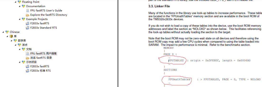

How to program rts2800_ml.lib to a fixed address?
For example, like below FPU method to operate rts2800_ml.lib

Daniel,
I have asked to have this post forwarded to the compiler team.
In the meantime here is the C28x compiler linking guide: processors.wiki.ti.com/.../C28x_Compiler_-_Understanding_Linking
Here is a forum post that you can browse through and see if the solution fits what you are looking to do with the rts2800_ml.lib.
e2e.ti.com/.../356218
Ozino
Daniel Fang said:How to program rts2800_ml.lib to a fixed address?
Please see this sub-chapter of the larger article Linker Command File Primer. Focus on the second of the two examples discussed.
