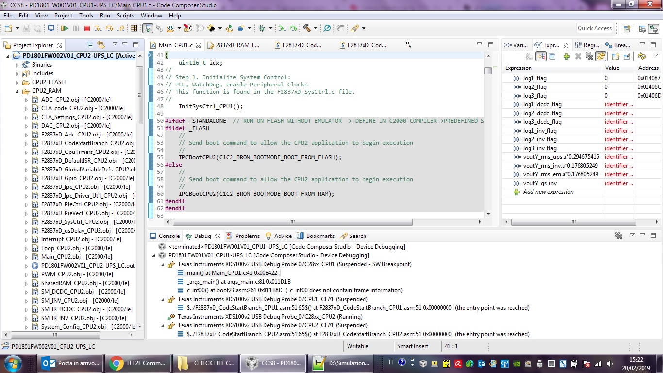

Naturally, Linker stopped to show me error about lack program space but when I try to loading code with my debug session, following observations need to be made:
1) CPU1 code is loaded correctly and, at the end of total programming process, the debugger point to main address;
2) CPU1_CLA code is  loaded correctly and starting when I lunch CPU1 code to generate a sw trigger for various task;
3) CPU2 code seems to be loaded correctly...
2) CPU2_CLA code is  loaded correctly and waiting a sw trigger from CPU2 code.
After program stage are completed, console show me follow:
C28xx_CPU1: GEL Output:
Memory Map Initialization Complete
C28xx_CPU1: If erase/program (E/P) operation is being done on one core, the other core should not execute from shared-RAM (SR) as they are used for the E/P code. Also, CPU1 will be halted to determine SR ownership for the CPU which will run the Flash Plugin code, after which CPU1 will be set to run its application. User code execution from SR could commence after both flash banks are programmed.
C28xx_CPU2: GEL Output:
C28xx_CPU2: If erase/program (E/P) operation is being done on one core, the other core should not execute from shared-RAM (SR) as they are used for the E/P code. Also, CPU1 will be halted to determine SR ownership for the CPU which will run the Flash Plugin code, after which CPU1 will be set to run its application. User code execution from SR could commence after both flash banks are programmed.
If I select Debug Tab I see that:
Differently than usual, CPU2 code start to run immediately... If I suspend it, console show me the follow error even if I don't insert any breakpoint:
C28xx_CPU2: Trouble Removing Breakpoint with the Action "Finish Auto Run" at 0x9800: (Error -1066 @ 0x9800) Unable to set/clear requested breakpoint. Verify that the breakpoint address is in valid memory. (Emulation package 8.0.903.4)
Finally, when I return in Debug Tab, I see CPU2 suspended where PC point to 0x3FE00A address where no symbol are defined. I obtain the same behavior if I load again code by load command (CPU2 running immediately and ...). I know, if I not in error, that address is a BOOT ITRAP; unfortunately, I don't understand where I stuck my cmd linker file. I tried to take a look at my map file but I didn't find nothing strange (obviously I attach that follow).
Can someone help me to understand what's going on? Thank's a lot.
