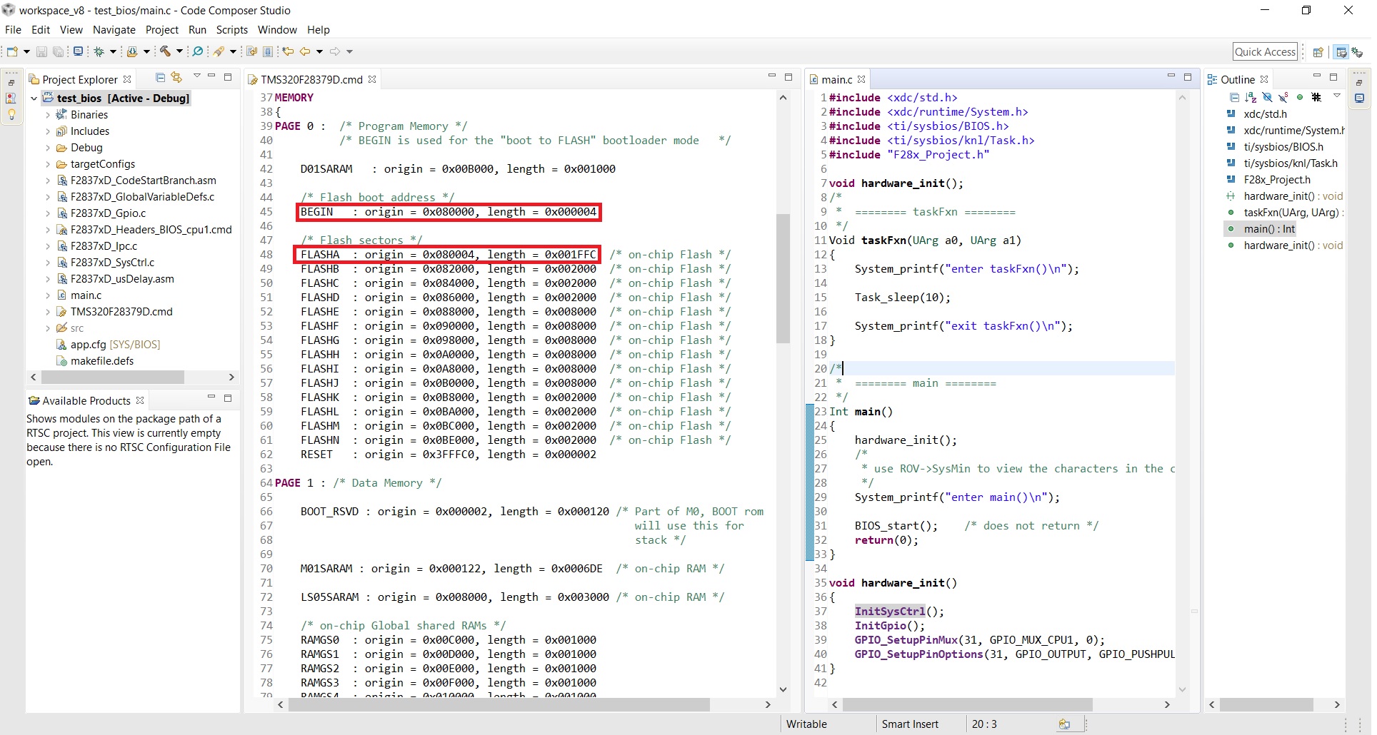

I am trying to build a simple program to blink the onboard LED using the SYS/BIOS. I've use the minimal SYS/BIOS template and added the essential initializing functions into the main(), based on the blinky example from the C2000ware device support as also linked the source and asm files. I've attached the console output. The error is related with the TMS32028379D.cmd linker file. How I can resolve this? Do I have to modify it the TMS32028379D.cmd linker file?  A link to the project: https://www.dropbox.com/s/htidha1ezi1zl6d/test_bios.zip?dl=0
Any help will be appreciated!

    Have you by any chance included 2 linker command files that assigns codestart to BEGIN memory region? Or may be assign some other region to BEGIN memory region?

    I have included two linker files the F2837xD_Headers_BIOS_cpu1.cmd and the TMS320F28379D.cmd ,  but i think that the first one does not assigned the codestart to any memory location. I have expanded the BEGIN memory region (+)2 and reduced the FLASHA (-)2 in the TMS320F28379D.cmd  and the project can be build now. But is this the right way to do this?

    But I thought your codestart section was only of size 0x2. Having a BEGIN region of size 0x2 is enough for that. Have you assigned any other section to BEGIN region? You can take a look at the .map file to see which sections are assigned to each memory region with their sizes.

    The .codestart section is indeed 0x2 long. Looking at the .map file I found that SYS/BIOS assigns the  section .ti_catalog_c2800_initF2837x_begin alongside with the .codestart in the BEGIN region as you've expect. How can resolve this? The only way so far as mentioned above, is to remove the CodeStartBrach.asm or modify the TMS320F28379D.cmd file. In every case, the code runs when debug, but after CPU reset the target seems to hang: Break at address "0x3ff16a" with no debug information available, or outside of program code but not if CPU restart or power-cycle.

    When you press CPU reset, it jumps to the init routine for which the debug symbols are unavailable in your .out. You could use the restart button which will execute the init routine and stops at start of main.
