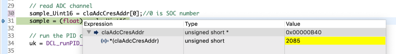

I set a breakpoint at Line 31 (shown below). When I hover the mouse over claAdcCresAddr[0], the pop-up window shows the pointer value is 0xB40, which is the correct ADCC result address. The window also shows the value at the pointed address is 2085 (0x825).

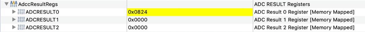

Nevertheless the Registers window shows the ADCC Result0 value is 0x824.

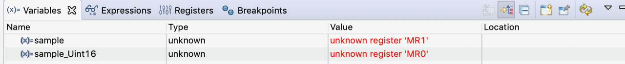

When I hover mouse over the local variable sample_Uint16, the variable doesn’t appear to be assigned a value. Only the declaration is shown. The information would disappear once I press a key, so I cannot save a screenshot. So instead I am showing the Variables window, which shows the local variables sample and sample_Uint16 do not have a value. This result would remain the same after I step through the function.
So, even though CCS is able to read ADCC SOC0 result using the pointer address, the value cannot be passed to the local variable. What did I do wrong here?

  • Problem solved. The CLA code was actually working, but debugger can’t seem to read out the variable value while debugging the CLA core. But once I copy them to Cla1ToCpuMsgRAM and debug the CPU core, I can see their values are correct.
  • Great! This may have been because you assigned the RAM to the CLA. I think this is the reason. I am not sure where sample was located but sample_Uint16 was on the scratchpad of the CLA memory.
