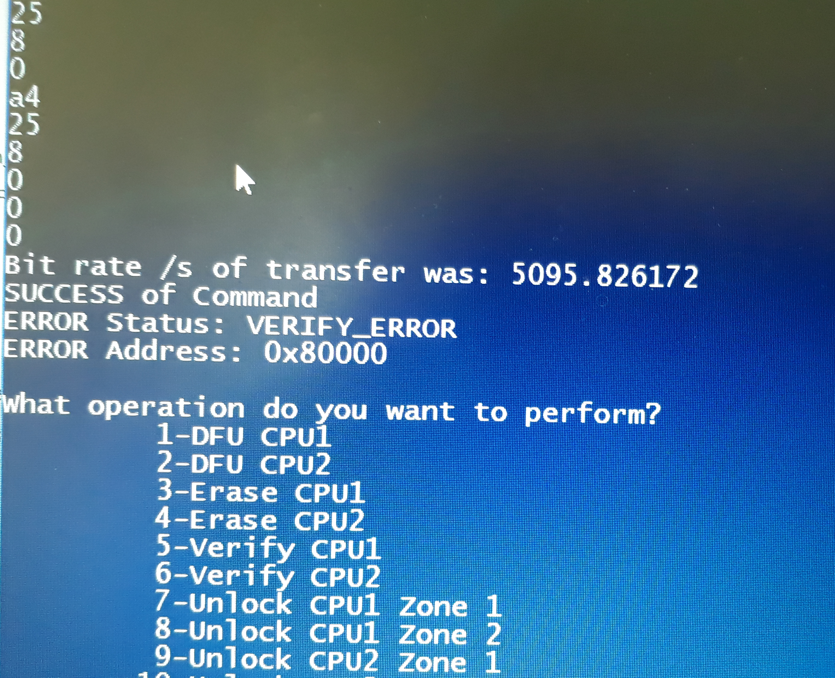

I want to program  TMS320F28377S using SCI. For this I am using serial flash programmer provided in C2000 and rom symbole lib given in C2000. I connect SCI A (GPIO 84, GPIO85) with serial port of PC using USB to TTL. And I call "SCI_Boot(0x00)" function from main just before while(1). And from debugger I can confirm this it enter in to this function. After this I run the serial flash programmer and I getting this on command promont

  • Sal,
    I try your files, run it many times. I observed that kernel was loaded successfully in microcontroller (line 2) but when it attempting for autobaud (line4) then it gets reset (line 5) and finally, the error comes. This is repeated result. And I disable the watchdog timer using the function "DisableDog()"
    Mr. Vikas suggest me to add " SciaRegs.SCIHBAUD.bit.BAUD = 0" in F2837xS_sci_flash_kernel file SCI_GetFunction.c-->SCIA_AutobaudLock() but result are same.
    One more thing  I am using LaunchPadXL TMS320F28377S Ver 1.0, in this GPIO 84,85 are not available on pinout. Ther GPIO84 is used for bootloader select switch and GPIO85 is used for iso7240 IC and it is difficult to connect the wire with these pins. Please give the part no of Launchpad you are using, so I try to arrange it.

  • SAL,
    I test boot loader on Launch Pad XL28377S TMS320F28377S VER 1.0. And I follow the following procedure.
    In the first step, I call boot loader in the main function and dump this program in launch pad using the debugger. Here boot configuration switch setting is sw1=High, sw2=High, sw3=High.
    void main()
    InitSysCtrl();
    DisableDog();
    run= SCI_Boot(0x00);
    Then I change setting boot configuration switch to sw1=High, sw2=Low, sw3=High. And then I remove LaunchPad from PC and reconnect it. Then I run the serial flash programmer but the results are same.
