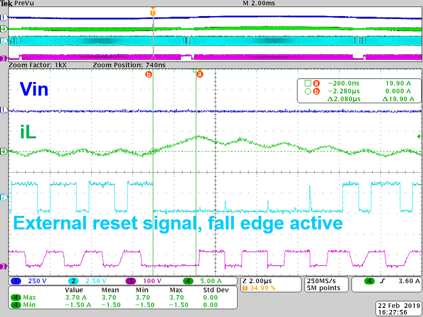

I have a problem that is related to EPWM output from DSP TMS320F28377S.

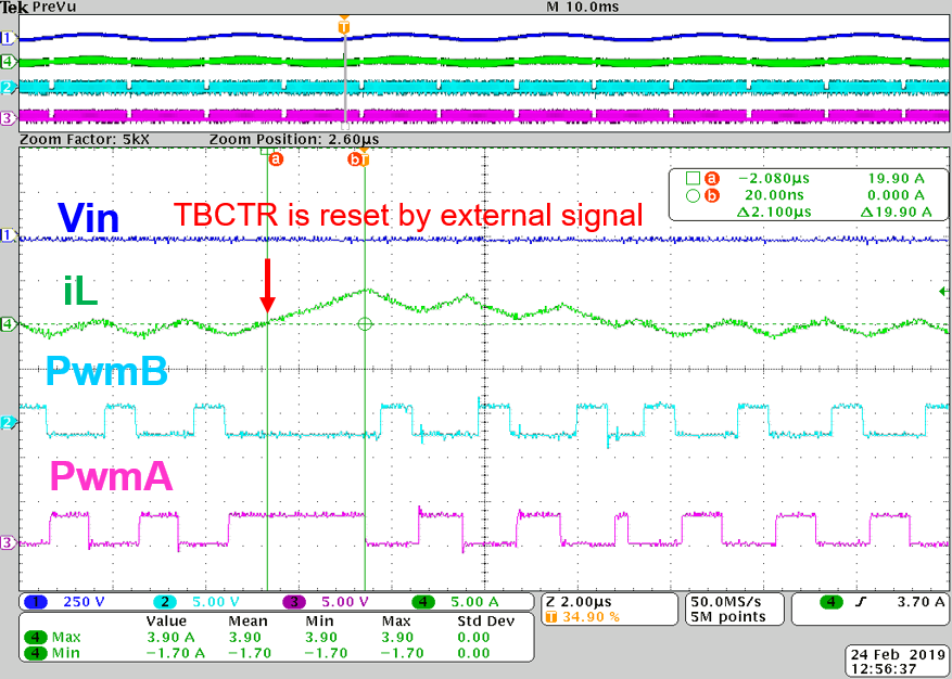

In my code, the EPWM7 output is updated based on the sensing signal and real-time calculation of the duty cycle in one interrupt. As shown in the following picture, the PWM output is occasionally all high in A and all low in B in one switching cycle, looking like a glitch or bug. i used complementary mode in PWM generation. And such glitch occurs in very low frequency (sometimes it takes ten seconds to capture one glitch). The sensed external signal and real-time calculation should be all right. Since my sampling frequency is 50kHz, and switching frequency is averagely 300kHz, if something wrong with the calculation and sensing signal, the PWM glitch will last for several switching cycles instead of only one cycle and occurs in so low frequency. so it looks more like a PWM glitch when updating the duty cycle.
I wonder, what will cause the EPWM module glitch or bug like this? How can i avoid such phenomenon?

    Can you also please clarify the red text in the 'scope capture: "TBCTR is reset by external signal"? Thanks.
    Richard
  • Can you debug this for me? I would like to know what value is in CMPA, CMPB when the signal is all the way LOW or HIGH in the PWM period.
    Thanks so much for your reply. The external signal is the zero-current detection signal from the hardware circuit. I send this signal through GPIO and link to EPWM7SYNCIN for reset the time-based counter. Everytime the reset signal is active, phase 0 will be loaded and the counter will start from zero. as you can seen in the following picture, the external reset signal is active just before the PWM glitch occurs. so it is like the time-based counter somehow did not reset with the EPWM7SYNCIN signal.
     As you mentioned, if it is true that a new TB period is written which is lower than the current TBCTR, the counter will miss the threshold and just keep on counting up, this may be one reason, i will check this later. Also, although i used synchronization function between master phase and slave phase (2 PWM modules), i did not set the slave phase PWM when debugging this problem.
