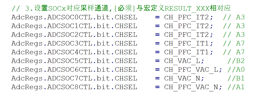

    // 1.���ò���ģʽΪ˳�����ģʽ,���Ϊ��һ����ģʽ
    AdcRegs.ADCSAMPLEMODE.all       = 0;
    // 2.ʹ���ڲ��¶ȴ�����
    AdcRegs.ADCCTL1.bit.TEMPCONV    = 1;
    // 3.����SOCx��Ӧ����ͨ��,[����]��궨��RESULT_XXX���Ӧ
    AdcRegs.ADCSOC0CTL.bit.CHSEL    = CH_PFC_IT2;  // ���ٵ����źŲ���,��PWM����
    AdcRegs.ADCSOC1CTL.bit.CHSEL    = CH_PFC_IT2;  // CH_PFC_IN_IAC;
    AdcRegs.ADCSOC2CTL.bit.CHSEL    = CH_PFC_IT2;  // CH_PFC_IN_IAC
    AdcRegs.ADCSOC3CTL.bit.CHSEL    = CH_PFC_IT1;  // CH_PFC_IN_IAC;
    AdcRegs.ADCSOC4CTL.bit.CHSEL    = CH_PFC_IT1;  // CH_PFC_IN_IAC;
    AdcRegs.ADCSOC5CTL.bit.CHSEL    = CH_VAC_L;     //result_5
    AdcRegs.ADCSOC6CTL.bit.CHSEL    = CH_PFC_VAC_L; //result_6
    AdcRegs.ADCSOC7CTL.bit.CHSEL    = CH_VAC_N;     //result_7
    AdcRegs.ADCSOC8CTL.bit.CHSEL    = CH_PFC_VAC_N; //result_8
    AdcRegs.ADCSOC9CTL.bit.CHSEL    = CH_VBULK;  // ����Ϊ�����źŲ���
    AdcRegs.ADCSOC10CTL.bit.CHSEL   = CH_VBULK;   //result_10
    AdcRegs.ADCSOC11CTL.bit.CHSEL   = CH_NTC_AMB;
    AdcRegs.ADCSOC12CTL.bit.CHSEL   = CH_NTC_LLC;
    AdcRegs.ADCSOC13CTL.bit.CHSEL 	= CH_LLC_DRV_UDC;//CH_PFC_IN_IAC;
    AdcRegs.ADCSOC14CTL.bit.CHSEL   = CH_LLC_DRV_UDC;
    AdcRegs.ADCSOC15CTL.bit.CHSEL   = CH_NTC_PFC;  //pfc�¶�

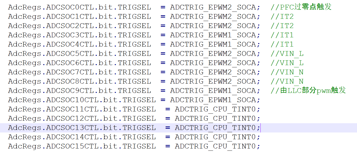

    // ����SOCx����Դ  //debug: ��Ҫ����ʵ��������е���
/*    AdcRegs.ADCSOC0CTL.bit.TRIGSEL  = ADCTRIG_EPWM1_SOCA;  //PFC����㴥��
    AdcRegs.ADCSOC1CTL.bit.TRIGSEL  = ADCTRIG_EPWM1_SOCA;  //IT1
    AdcRegs.ADCSOC2CTL.bit.TRIGSEL  = ADCTRIG_EPWM1_SOCA;  //IT1
    AdcRegs.ADCSOC3CTL.bit.TRIGSEL  = ADCTRIG_EPWM2_SOCA;  //IT2
    AdcRegs.ADCSOC4CTL.bit.TRIGSEL  = ADCTRIG_EPWM2_SOCA;  //IT2
    AdcRegs.ADCSOC5CTL.bit.TRIGSEL  = ADCTRIG_EPWM1_SOCA;
    AdcRegs.ADCSOC6CTL.bit.TRIGSEL  = ADCTRIG_EPWM1_SOCA;
    AdcRegs.ADCSOC7CTL.bit.TRIGSEL  = ADCTRIG_EPWM2_SOCA;
    AdcRegs.ADCSOC8CTL.bit.TRIGSEL  = ADCTRIG_EPWM2_SOCA;   //��LLC����pwm����
    AdcRegs.ADCSOC9CTL.bit.TRIGSEL  = ADCTRIG_EPWM1_SOCA;   //��LLC����pwm����
    AdcRegs.ADCSOC10CTL.bit.TRIGSEL  = ADCTRIG_EPWM1_SOCA;
    AdcRegs.ADCSOC11CTL.bit.TRIGSEL  = ADCTRIG_CPU_TINT0;
    AdcRegs.ADCSOC12CTL.bit.TRIGSEL  = ADCTRIG_CPU_TINT0;
    AdcRegs.ADCSOC13CTL.bit.TRIGSEL  = ADCTRIG_CPU_TINT0;
    AdcRegs.ADCSOC14CTL.bit.TRIGSEL  = ADCTRIG_CPU_TINT0;
    AdcRegs.ADCSOC15CTL.bit.TRIGSEL  = ADCTRIG_CPU_TINT0;
    AdcRegs.ADCSOC0CTL.bit.TRIGSEL  = ADCTRIG_EPWM2_SOCA;  //PFC����㴥��
    AdcRegs.ADCSOC1CTL.bit.TRIGSEL  = ADCTRIG_EPWM2_SOCA;  //IT2
    AdcRegs.ADCSOC2CTL.bit.TRIGSEL  = ADCTRIG_EPWM2_SOCA;  //IT2
    AdcRegs.ADCSOC3CTL.bit.TRIGSEL  = ADCTRIG_EPWM1_SOCA;  //IT1
    AdcRegs.ADCSOC4CTL.bit.TRIGSEL  = ADCTRIG_EPWM1_SOCA;  //IT1
    AdcRegs.ADCSOC5CTL.bit.TRIGSEL  = ADCTRIG_EPWM2_SOCA;  //VIN_L
    AdcRegs.ADCSOC6CTL.bit.TRIGSEL  = ADCTRIG_EPWM2_SOCA;  //VIN_L
    AdcRegs.ADCSOC7CTL.bit.TRIGSEL  = ADCTRIG_EPWM2_SOCA;  //VIN_N
    AdcRegs.ADCSOC8CTL.bit.TRIGSEL  = ADCTRIG_EPWM2_SOCA;  //VIN_N

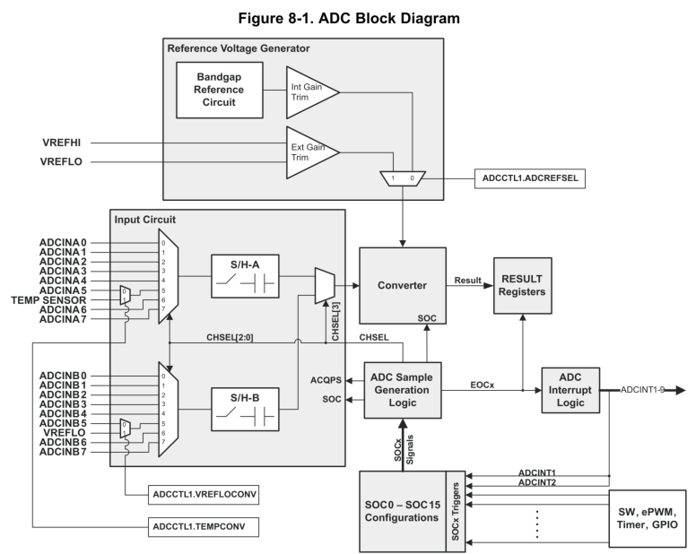

    3# If the ADC CHSELs repeated changing from ADCINB to ADCINA pins could cause the ADC sampling results error? As the below shown, the SOC5 to SOC8, the channels change from ADCINB to ADCINA which is for Vin sampling.

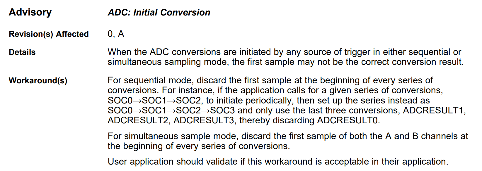

    4# The last question, information from F2803x Silicon Errata document as the below shown, there need discard the first ADCResult value from the series of SOC0->SOC1->SOC2->SOC3. As the customer's code, EPWM2 trggers SOC0->SOC1->SOC2->SOC5->SOC6->SOC7-SOC8. Which ADCResult should discard in case there is incorrect value, SOC0 or SOC0&SOC5?

  • Rayna,
    I don't think we need to look at the compiler optimization just yet.  I'd like to focus on the Q3 from your previous post:
    Based on the trigger configuration I beleive that when EPWM2SOCA is received ADCRESULT0 will not always be reliable and should not be used.  From configuration it looks like customer samples A3 on SOC0/1/2, so likely they are discarding and then averaging SOC1/2
    The trigger EPWM1SOCA is a bit trickier; since the triggers are not in order(EPWM2SOCA has some triggers between the SOCs) there is possibility that depending on when EPWM1SOCA is received either SOC3 or SOC9 could be the first conversion from ADC idle.  So, both ADCRESULT3 and ADCRESULT9 cannot be trusted since they could both be the first conversion from idle.
    Finally SOC11 is the first conversion triggered by TINT0, so it would also be potentially bad/in error.
    Can you confirm that customer is discarding these samples per above?
    For your Q2, the switching between the A channel to B channel is interesting, since these are two different S/H capacitors.  If either S/H cap(A or B) is unused for a long time it will re-settle to steady state voltage which may mean it needs more time to charge.  If customer is observing correct time constant, based on S/H network then this should be covered.

  • Rayna,
    Can you see if the ADC advisory discussed in the following post might explain the observations: e2e.ti.com/.../2892844
    -Tommy
