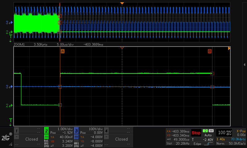

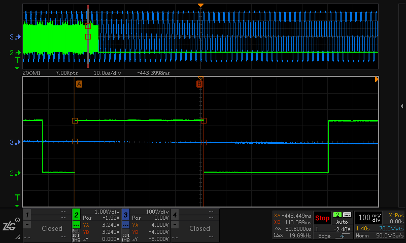

    Then I watched the waveform of GPIO8,GPIO8 set after entering the interrupt, and cleared before exit the interrupt. I found that the ADC interrupt terminate when its run time is between 49.4us - 49.5us. When ADC interrupt's run time is larger than 50us, the ADC interrupt didn't terminate. Why?
    PS: the ADC interrupt’s normal trigger time is 50us, CH2 is the waveform of GPIO8

  • user4848357,
    You original post described the ADC triggering rate as 50us:
    user4848357 said:
    interrupt 1: ADC interrupt, ADC triggerd by Timer0 (50us period),ADC interrupt is triggerd by the completion of the whole sampling.
    When your ISR is near 50us long, it is almost certain that the next batch of ADC SOCs are triggered while your ISR is executing. Here are three likely outcomes:
    • If the ISR clears the ADCINT and PIE flags before the new SOCs complete, you will not encounter an overflow condition.
    • If the ISR clears the flags after the new SOCs complete, you will have an overflow condition, but the overflow state is cleared with the flags.
    • If the ISR clears some (but not all) flags after the new SOCs complete, you may have an overflow condition that is not serviced
    To avoid overflows, you should either reduce your ISR execution times so that real-time servicing requirements can be met, or configure the ADC interrupts to operate in continuous mode so that the overflows are ignored.
    -Tommy

  • Tommy,
    I have already tested that only when the ADC interrupt service time is between 49.3us to 49.5us,the ADC interrupt will terminate. But the other chip don't behave like this with the same code. You can see the test waveform in the previous reply.
    When the ADC interrupt service time is over 50us, there must be a overflow, but the ADC interrupt is still run with or without clearing ADCINTOVFCLR.
