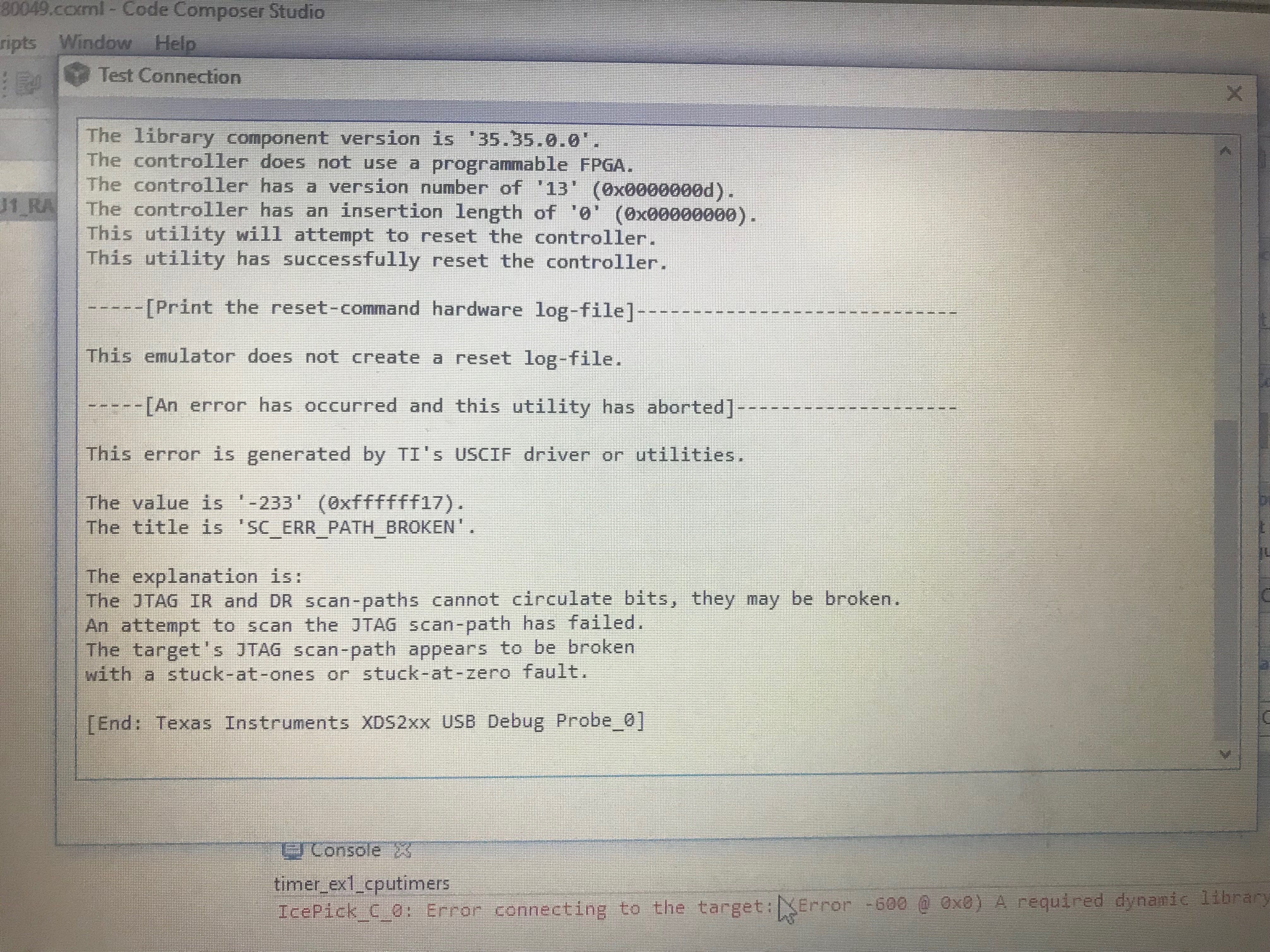

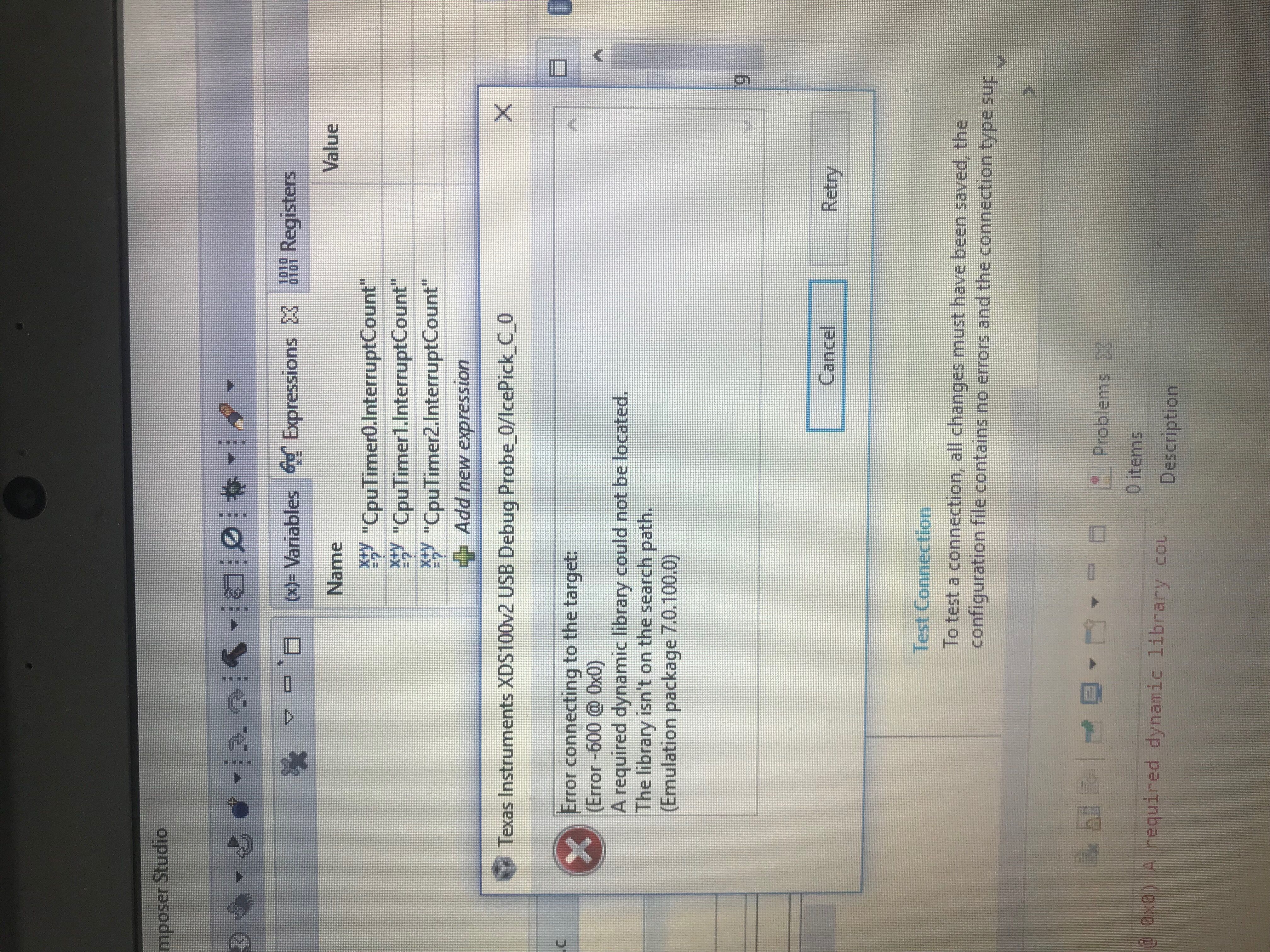

    My customer used TI TMS320F280049 design a new project, in current customer just use XDS200 to connect the target board with CCS7.4. but customer connect the target failed. After create " Target configuration File "in CCS7.4 and configured OK, click "Test connection" button in .ccxml file, the testing result failed as the following picture show:
And connect the target board via JTAG ,error message as below picture show:
  Please kindly help to give suggestions to resolve this problem. thanks !
