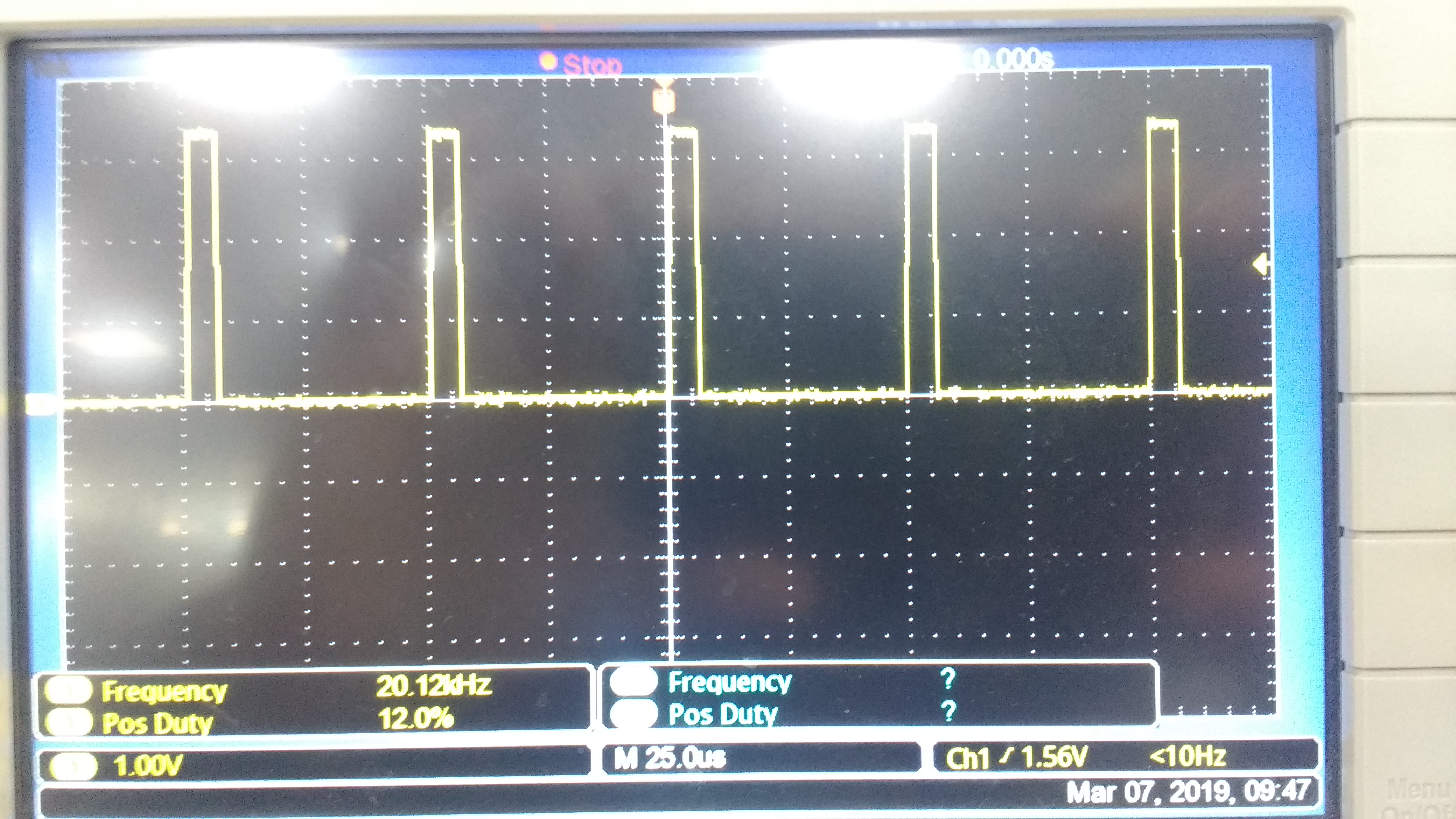

I am using DRV8312-69M-KIT with 2806xISO control card. I am running sample code BLDC_Sensored from ControlSuit. All build level (LEVEL1 to LEVEL6) are running successfully. My question is as per PWM configuration PWM switching frequency is set 20 kHz but the actual PWM frequency in output waveform is in Hz. How this frequency is changing?
  • Do you have any waveform to show this question? And post the configuration code for the System Clock and PWM. What's the EPwm1Regs.TBPRD?
  •  Please find below path of the example code and attached waveforms of EPWM2A and EPWM2B.

  • You might zoom in the waveform of channel "1" to check the PWM frequency as the first figure you posted. It seems like the PWM frequency is correct. The second figure shows the frequency on channel 2 is the commutation frequency of the motor, not PWM frequency. You might have a look at the application guide in the folder of example project in controlSUITE that should help you to understand the concept of BLDC control.
    Please check the configuration code for CPU clock and PWM if the PWM frequency is not right as you want, or post these code if you have any further question.

    How do I calculate this commutation frequency?
  • The commutation frequency is based on the motor speed, it's 6 times to the motor electrical frequency. Please have a look at the application guide in the following folder of controlSUITE.
