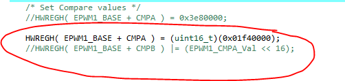

I am trying to demonstrate the ePWM operation using base address and offset . I have done all configuration carefully.
But i have some issue. I can set all specific register regarding ePWM configration but i am not able to set CMPA register.
Also there is issue is that TBCTR reg. TBCTR is not starting the counting.
Can you suggest what may wrong ?

    HWREGH( EPWM1_BASE + CMPA ) = (uint16_t)(0x01f40000);
