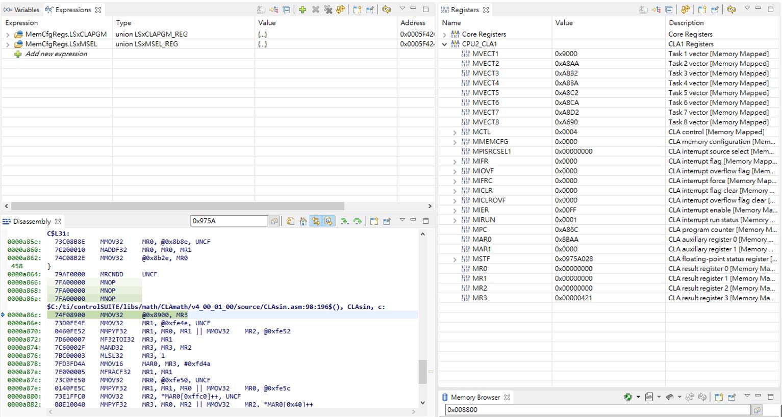

I use CLA in CPU2  LSxRAM.
CLA program is  in LS2+LS3+LS4+LS5 RAM .
CLA DATA  is in LS0+LS1 RAM.
I make sure LSxMSEL.bit.LS0/LS1/LS2/LS3/LS4/LS5 =1,
also LSxCLAPGM.bit.LS2/LS3/LS4/LS5 =1,
But when CLA program run into LS5RAM (after 0xA800),  there are many wrong behaviors with CLA.
example as below picture:
The MSTF return address is 0x975A when CLA excute into 0xA864 code.
But CLA do not return to 0x975A and the  program continues to execute 0xA86C.
Any suggestion with this situation?
