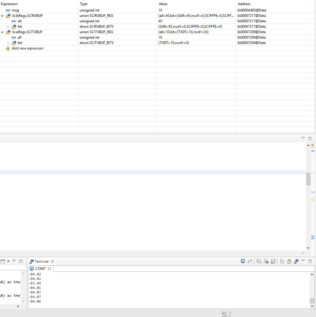

  • I'm receiving data from a inertial sensor. I want to use this data to manipulate another part of the code. So, in order to do that, I need the incoming values to be as integers that i can compare. I tried using uint16 and see how the output reads as:
    SCIBREGS' SAR value is 45 which means that it is '-' equivalent in decimals.
    It can be seen that the output on the comport is pretty accurate. However, I am not able to use it to compare.
    I hope this is much clear now.
  • Hi silso,
    So a reading from the sensor in this case will be 6 char's received as 6 separate SCI words?
    Before compare you'd want to write a function that turns the character string into a float. Probably there is an in-built C function that you can use, or you'd do something like:
    (char[1] - 48)*10 + (char[2] - 48)*1 + (char[4] - 48)*0.1 + char[5] - 48)*0.01
    (But you'd need to make it robust to work for different signs and possibly different lengths)
