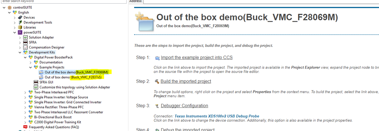

1- My first one, I  have recently bought  this
I want to test   this launchPAd F280049C with  Digital Power Buck Converter BoosterPack.
My problem is that I'am afraid that it won't  work because  in control Suite they said it is only compatible with F28069M or F2837xS
Which  version should I use ??? is there any modifications in the code to do to make it  compatible with My device  ???

    The BOOSTXL-BUCKCONV and LAUNCHXL-F280049C are pin compatible. However, there is no software example available today to operate the two together. A working example for the BOOSTXL-BUCKCONV and LAUNCHXL-F280049C combination is expected to be available around 3Q19.
    Porting the software to F280049C will take some detailed work, even for someone who is familiar with the devices. If you wish to proceed with porting, it will be easier to use the F2837xS example (as opposed to the F28069M example) as a starting point because F2837xS and F280049C have very similar architectures.
    If you wish to observe a running example on any platform, it would be easier to purchase the LAUNCHXL-F28069M to use the existing software.

  • Zi123D CH123KHA said:
    When I buy a F2837xS , normally the code will run automatically without any problems ?? (without the  need of porting from F28069M coz the code is already existed in CCS).
    The LAUNCHXL-F28377S board was discontinued and replaced by the LAUNCHXL-F28379D board. If you can manage to obtain a LAUNCHXL-F28377S board, it will work with the controlSUITE demo as-is.
    The LAUNCHXL-F28377S code will execute on the LAUNCHXL-F28379D board, but the header pin assignments are different between the two boards so you would need to make modifications to the software to handle the different pins.

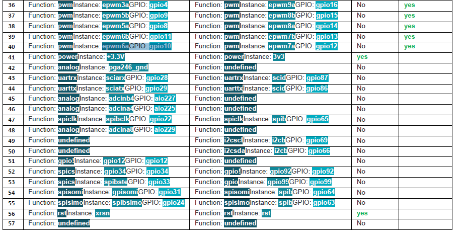

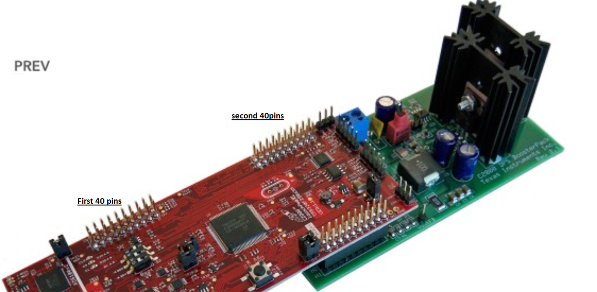

    Based on our previous discussion, I bought a  F280049C LaunchPad.
    I do a small comparaison of pins between F280049C/F2837xS , presented on this Table
        My question is I do not understand why the connections is on the first 40 pins(1-->40) and not on  the second 40pins  (40-->80)( we have 80 in total)  as you see  in this picture .Normally in the picture the pins from  40 to 80 are connected to the boosterPack.
    I know that We have two Booster connections , but I found it so weird to connect the first pins ???????

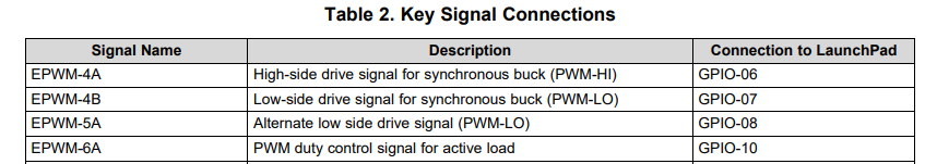

    My second question , Why we have 6 channels of PWMs are connected to the boosterPack.
    Normally based on the datasheet we need 4 channels as mentionned on this Table
    "www.ti.com/.../tidu986.pdf"
    It sounds to me like you are going about this exercise backward. You must also use the second set of headers (pins 40-80) on LAUNCHXL-F280049C or else BOOSTXL-BUCKCONV will not fit because of the heat sinks. Therefore, the correct exercise is to change the module assignments and resources to be used by F280049C in order to use the desired headers.
    The only required signals are EPWM-4A, EPWM-4B, and EPWM-6A. If you look at the BOOSTXL-BUCKCONV schematic, you will see that EPWM-5B and EPWM-6B are connected to the header, but are not used by any components. EPWM-5A is included for flexibility and is not needed.
