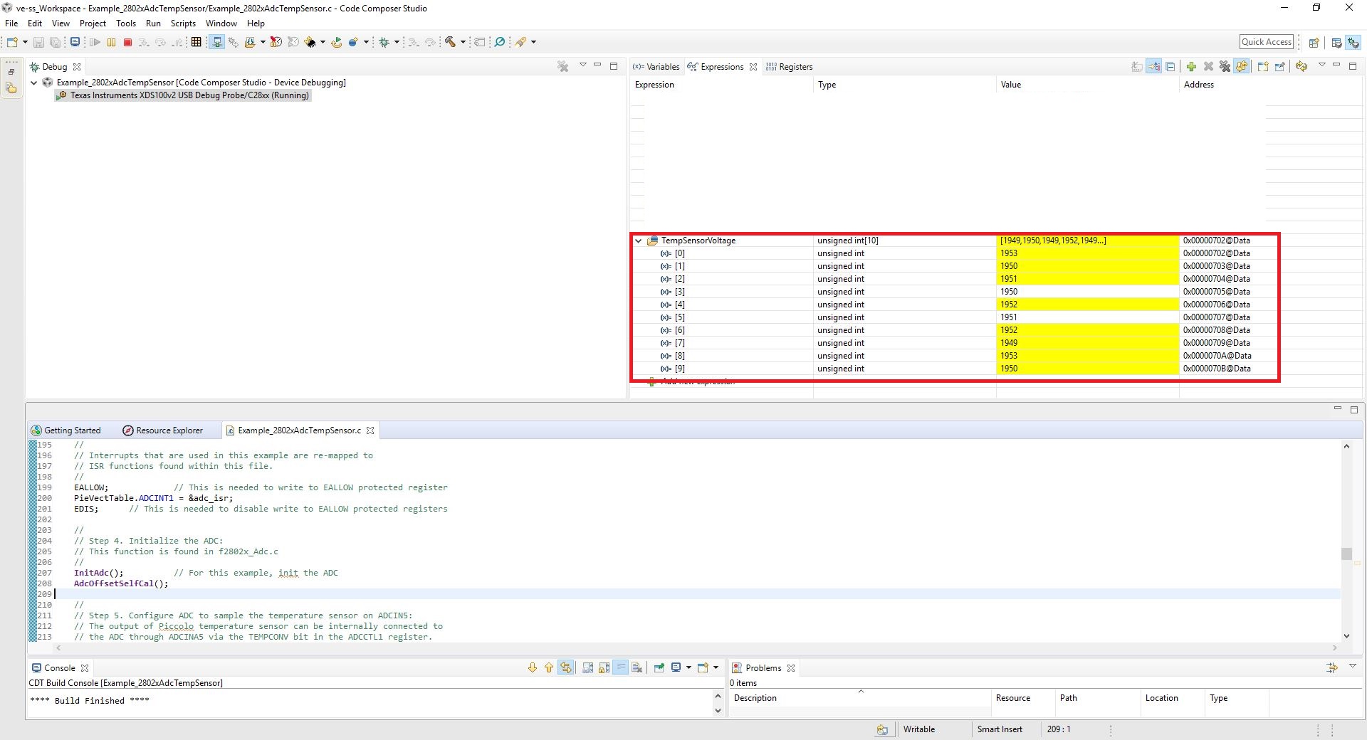

    This screen is from running on RAM. I get the values of the temp sensor in yellow background.

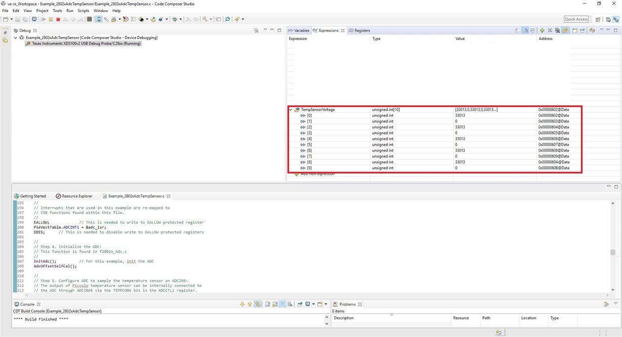

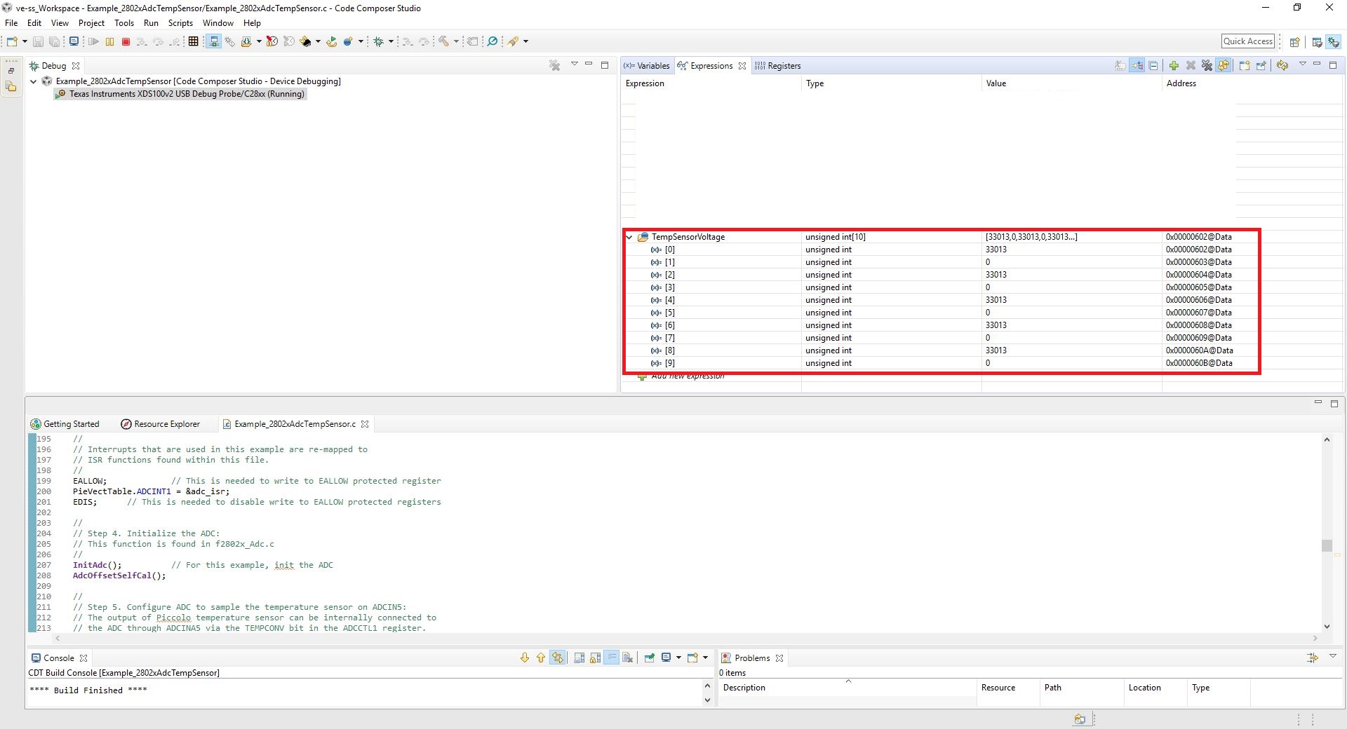

    This screen is from running on FLASH. I don't get the values of the temp sensor. But there is no error!

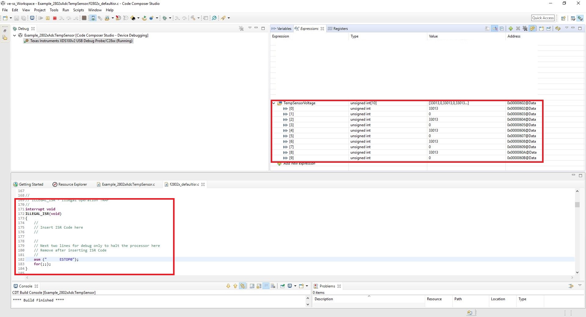

    The same problem occurs when I comment out the AdcOffsetSelfCal(). The difference is that the program jumps into the ILLEGAL_ISR(void). I don't know how to interpret that.
