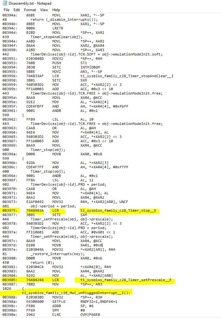

I pulled the disassembly from the debugger and noticed the Timer Prescale executions before the unPluggedInterrupt() occurs. Is something wrong with the timer settings? I am using the same device clock configurations as in the device.c/.h files for the F28377x family, specific to LaunchPadXL.

  • Hi Todd, Interrupt 19 implies an illegal action occurred. I checked the PIE vector address (0xD26 - Illegal Instruction/TRAP). I am not sure what is causing this illegal instruction based on the disassembly. I wonder if the timer configuration setup has anything to do with it?
    I am using an interrupt for the I2C_A module and I have configured the interrupt accordingly in BIOS- using Hwi_create([interrupt number], [&isr], [HwiParams]); and I can see the interrupt enabled in the PIEIER registers. I would like some help from the disassembly to figure out if a timer configuration is causing this illegal action trap.

  • I doubt the timer has anything to do with it. I expect it just happens to be next to it.
    The kernel does not plug the illegal interrupt and you aren't either, so that's why the message is coming out. So what's causing the illegal operation? Can you try simplifying your code and see if it goes away? It sounds like you never make it to BIOS_start...is that correct?
