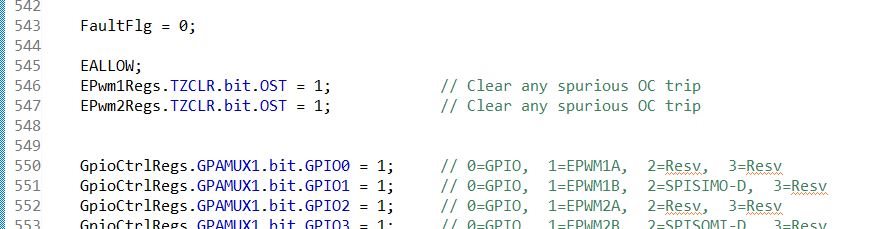

I am trying to analyse and test the Peak Current Mode Control code (HV-PSFB) in open loop by providing the Iout, Ipri, Vin and Vout signals to the MCU, but I don't get any PWMs out of the microcontroller. For the voltage signals I use a DC voltage generator (~2V) and for the current signals I generate sawtooth signals (top one - Iout, middle one - Ipri, last one - Vout), as it can be seen on the attached screenshot. At the GUI I noticed that the Fault Flag is 1.00, but I am not sure why the fault is high, since I haven't done any changes in the code.
Do you have any ideas why I don't see any PWMs coming out of the microcontroller and how can I resolve it?

    Please see the following post https://e2e.ti.com/support/microcontrollers/c2000/f/171/p/714212/2635464#2635464  There is a known bug in this code, and a corrected version is supplied in this thread(from TLEE about half way down).  Let me know if the new .out file solves your issue.
    Matthew
  • Hi Matthew,
    Unfortunately, this does not resolved my problem. I followed the steps but still the Fault flag is 1.00. Please, refer to the attached screenshots.

  • Hi, user5875413,
    It seems like you triggered the current protection. Can you try to lower your Ipri amplitude? The peak value is more than 2V in your figure.

  • Hi Chen,
    Thank you for your suggestion. Unfortunately, even if I lower the Ipri peak to 0.5V my Fault flag is still high. Currently, I am feeding the Ipri signal to pin8 of J1 and a DC voltage to pins 6 and 7 of J5 feeding the Vout and Vin respectively. Based on the User's guide this should be sufficient to evaluate the operation of the code and to generate the PWMs, am I correct?
    What could be the potential reasons for tripping the fault flag to high?

  • Hi user5875413,
    I suggest to check your current ADC sensing in the expression window. You can set a relatively large trip value first and to observe whether the sensing value makes sense.
