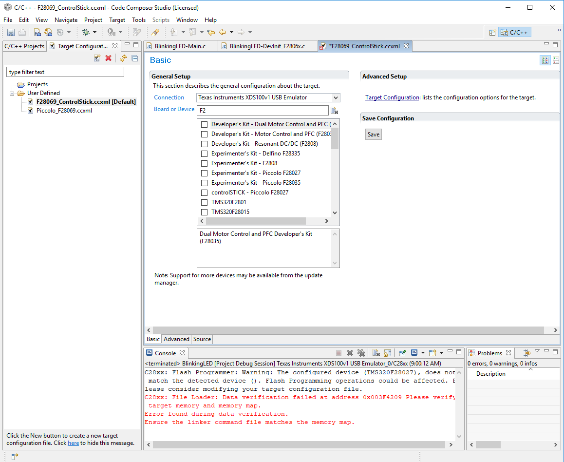

Hello All,
When attempting to run the F28069 Blinking LED example code, I find that no target matches my F28069 controlStick in CCS Ver 4.2.1.00004. I tried selecting the F28027 Target hoping that it would work but no luck.
Why does my installation not have a controlStick F28069 target? The product I purchased is P/N: TMDX28069USB.The onboard controlStick device is: TMX320F28069PNA.
I tried updating my installation of CCS and it says its up to date.
Last week I had CCS v7/8, controlSuite 3.4.9 and some C2000 ware installed and when attempting to run the blinking LED demo the system informed me that the code for the Blinking LED was done on an earlier version of the compiler. The suggestion I saw at the time in E2E was to uninstall everything and get the necessary version of CCS. I done it and my device that should be in the list of available devices is not there.
Can anyone offer advice on how to fix this problem?
Thank you.
  • The above image is the screen capture of the target setup.
  • The CrossHairs Demo does not connect to my F28069 controlStick either. I don't know if its related but I just want to provide information that might help someone figure out what is happening on my machine.

  • Kenneth,
    As you may already know, the F28069 controlSTICK is an obsolete target board, as well as CCSv4 is a very old debug tool. I am guessing that you installed CCSv4 from the disk that came with the F28069 controlSTICK. The F28027 target configuration file will not work with the F28069 device. (The linker command file and CCS memory map will not match). You could have equally used the 'TMS320F28069' device configuration (rather than the controlSTICK version); however, I strongly suggest fully uninstalling CCSv4 and installing CCSv8 with the latest version of C2000Ware (1.00.06.00). When setting up the target configuration file in CCSv8, you will find both the 'controlSTICK - Piccolo F28069' and the 'TMS320F28069' under "Board or Device" for the XDS100v1 USB Debug Probe connection.
    After installing CCSv8, set up the target configuration and then click 'save'. Before closing the configuration window, click 'Test Connection'. I notice that this is missing in your screen capture. This will confirm that the connection is working.
    As for the message about the project being built with an earlier version of the compile, you can rebuild the project with a later version by changing the complier version in the project properties.

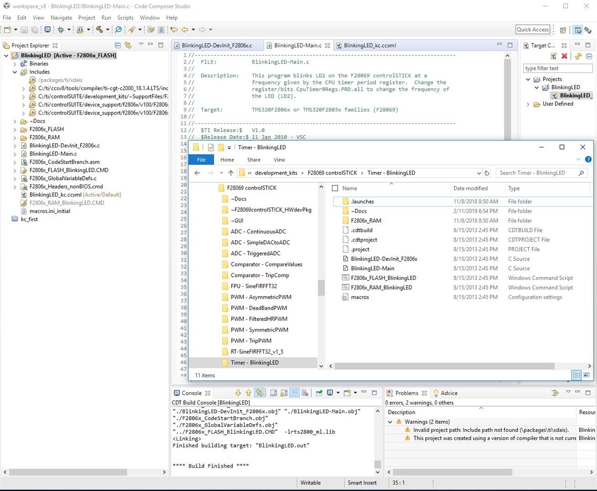

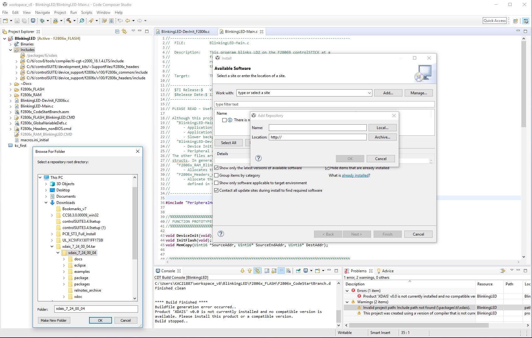

    I have CCSv8 installed on my other laptop and I'm experiencing an error associated with xdais not being installed. I found ver 7.24, downloaded it and added it locally. Nonetheless, the Project Explorer shows the "packages/ti/xdais" grayed out. And the build error says xdais not found. I closed and reopened CCS after the xdais install through the "Add Repository."
    Does anyone have any recommendations on how to solve the invalid path to xdais problem?
    Secondly, my company has a restrictive internet access policy that severely impacts the ability of CCS to access updates and downloads. So to overcome the Warning:
    This project was created using a version of compiler that is not currently installed - 5.2.2 [C2000]. Another version of the compiler will be used during build - 18.1.4.LTS. See 'Help > Install New Software' and select 'Code Generation Tools Updates' to check if this compiler is available through a CCS update. Visit CCS App Center to get the latest compiler support. Or <a href="">download and install the compiler, then register it with CCS through 'Preferences > CCS > Build > Compilers'.
    How/Where do I get the CCS 5.2.2 compiler if its really necessary? Can I manually download it and add it as the warning describes?

  • Kenneth,
    At this point, it looks like you are able to connect to your controlSTICK. Please review the following thread and see if it solves your xDias issue:
    e2e.ti.com/.../2008927
    Could you please tell me which project you are trying to build? Is it from controlSUITE or C2000Ware?
    - Ken
  • Ken,
    Thanks again.
    The solution shown in the thread solved the problem for the xdais error.
