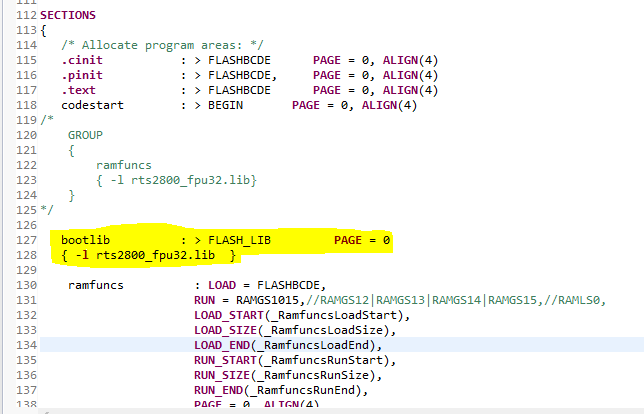

Recently, my customer met a problem seems related to unwanted linking of rts2800_fpu32.lib in CMD file. The phenomenon is stack pointer (SP) sometimes run into error address like 0xFE00 and program stuck. (stack area start at 0x400 with a length of 0x100)
They limited the problem with a possible error linking command in CMD file like below:
They put rts2800_fpu32.lib into FLASH sector E in F28377D cpu1, I have never heard a practice like this, could you confirm this for me?
Additional questions in this problem:
1. Where can I find the linking rule of this library? (I saw some objective files in this library linked to .ebss some else to .text in example project)
2. If rts2800_fpu32.lib should not be linked into non-volatile memory like a flash, how does it case the SP overflow? Could you give a brief explanation on this?
