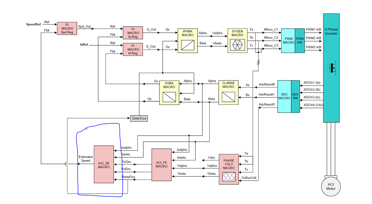

Hi all,
I am working on Sensorless HVAC8_Sensorless_2833x project,
Could someone tell me please for what Apha states, A branch states, B branche states and C branche states stand for?
I am looking also for the Estimated Speed equation,
Thanks in advance,
S.Tarik,
  • 1. It's a state machine control, just uses a timer to execute the control code by turns in the background loop. It's not critical for motor control, you could use any other methods to replace them if you want.
    2. You might find all the equations in the software library documentation in the below folder if you installed controlSUITE.
    C:\ti\controlSUITE\libs\app_libs\motor_control\math_blocks\v4.3\~Docs
