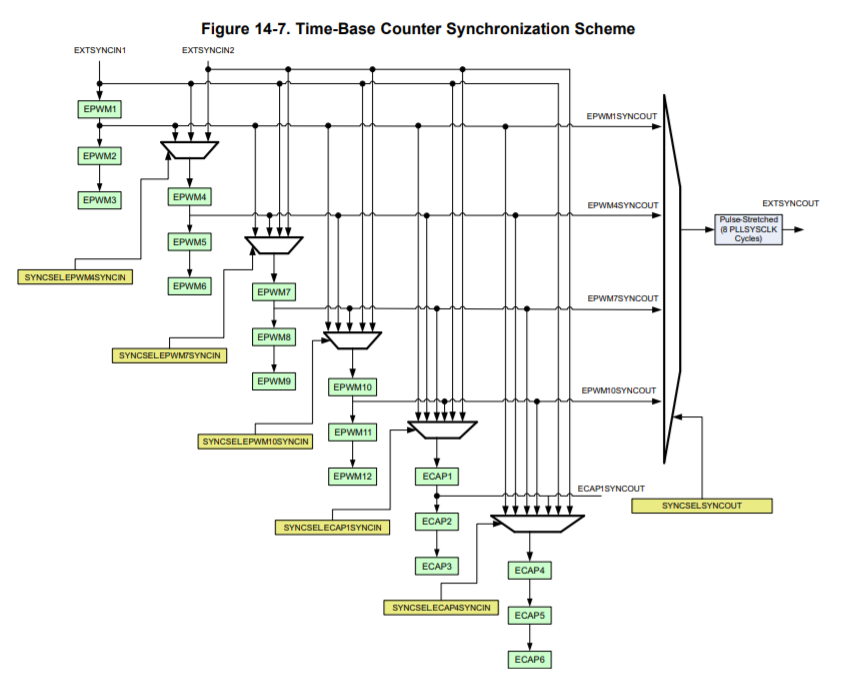

Hello!
I want to give phase shift between all the modules of epwms but I am not able to do that.
Suppose my reference is epmw2, then epwm 6( the next available epwm) should be shifted by 15 degrees, EPWM7 should be shifted by 30 degrees with respect to EPWM 2 and so on.
Here is the code I am using:

#define delay 0U
#define time_base 500U //EQUIVALENT TO 50khz FCLK=50MHZ
void EPWM_init(int epwm_group);
void EPWM_setupCommon(uint32_t base, bool phase_enable, uint16_t phase_shift, int count_mode);
   uint32_t phase_a_base;
   uint32_t phase_b_base;
   uint32_t phase_c_base;
   //EPwm1Regs.TBPHS.half.TBPHS = 0x0010
  // EPwm1Regs.TBCTL.bit.PHSDIR = TB_UP;
   uint16_t phase_shift_count = 14U;
   EPWM_SyncCountMode sync_count_mode = EPWM_COUNT_MODE_UP_AFTER_SYNC;  // PLAY WITH THIS
   bool phase_enable = false;
   switch(epwm_group)
      case 1:
         phase_a_base = EPWM1_BASE;
         phase_b_base = EPWM2_BASE;
         phase_c_base = EPWM3_BASE;
         phase_shift_count = 0U;
         break;
      case 2:
         phase_a_base = EPWM4_BASE;
         phase_b_base = EPWM5_BASE;
         phase_c_base = EPWM6_BASE;
         phase_shift_count = 10U;
         phase_enable = true;
         break;
      case 3:
         phase_a_base = EPWM7_BASE;
         phase_b_base = EPWM8_BASE;
         phase_c_base = EPWM9_BASE;
         phase_shift_count = 14;
         break;
      case 4:
            phase_a_base = EPWM10_BASE;
            phase_b_base = EPWM11_BASE;
            phase_c_base = EPWM12_BASE;
            break;
      default:
         break;
   EPWM_setupCommon(phase_a_base, phase_enable, 0, sync_count_mode);
   EPWM_setupCommon(phase_b_base, true, 14U, sync_count_mode);
   EPWM_setupCommon(phase_c_base, true, 14U, sync_count_mode);
    uint32_t q=base;
    int i=200;
   // Set-up TBCLK
   EPWM_setTimeBasePeriod(base, time_base);
 // EPWM_setCountModeAfterSync(base, count_mode);
   EPWM_setPhaseShift(base, 14U); //phase_shift);
   EPWM_setTimeBaseCounter(base, 0U);
   // Set Compare values
   EPWM_setCounterCompareValue(base, EPWM_COUNTER_COMPARE_A, i);
   // Set up counter mode
   EPWM_setTimeBaseCounterMode(base, EPWM_COUNTER_MODE_UP_DOWN);
   if(phase_enable == true)
      EPWM_enablePhaseShiftLoad(base);
      EPWM_setSyncOutPulseMode(base, EPWM_SYNC_OUT_PULSE_ON_EPWMxSYNCIN);
   else
      EPWM_disablePhaseShiftLoad(base); // was disable
      EPWM_setSyncOutPulseMode(base, EPWM_SYNC_OUT_PULSE_ON_COUNTER_ZERO);
