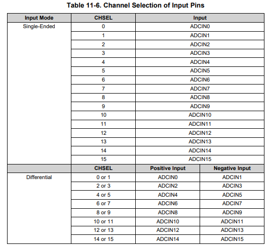

  • Hi Kevin,
    To set the ADC in differential mode you need to use the ADC set mode function to configure the signal mode and resolution.  This is a global ADC setting; it can't be configured per SOC.
    For the channel selects, if you look at the TRM, you can see that CH = 0 or CH = 1 is equivalent to CH = 0&1.

  • Hi Kevin,
    Sorry, looks like I missed your key question in the original post.
    Only the differential combinations listed in the table above from the TRM are possible.  The silicon does not support something like D0 and D3 as a differential pair, only (D0 and D1) or (D2 and D3).
    You'll have to work around the available pins and pin topology in your particular EVM. We understand that this is not optimal. In your end application, you can layout the channels however you want, which should allow nicely differentially routed channel pairs.

  • Great, I totally understood this. Finally, if I put
    ADC_setupSOC(ADCD_BASE, ADC_SOC_NUMBER0, ADC_TRIGGER_SW_ONLY, ADC_CH_ADCIN0_ADCIN1, 250);
    Am I telling the ADC to get as ADCD first conversion result0 = (ADCIND0 - ADCIND1), right?
  • Hi Kevin,
    Yes, that is correct. Do note that the difference can't be between arbitrary voltages ('true differential') but instead is the difference between two signals reflected about the common mode voltage ('fully differential'). The common mode voltage should always be near VREFHI/2.
